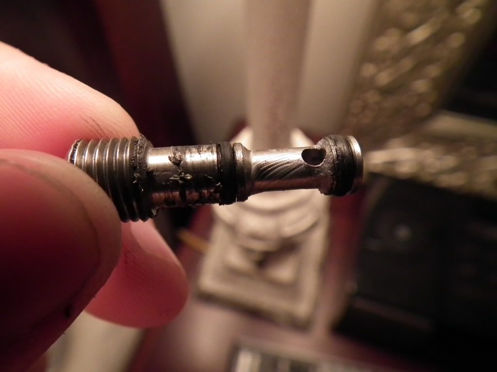

Alright Gents, After heading advice to re lube my Regulator I took the initiative to totally and completely clean it.
This is what my HPR Internals looked like at 4863 shots. Could this potentially be why My velocity was no higher then 250 FPS. and potentially a cause of my First, Second, Third, Fourth and sometimes Fifth shot drop off?

Absolutely!
I didn't think the regulator would be an issue considering the gun was brand new. Not sure how the velocity adjuster got to look like this. That's terrible. Replace those o-rings (DUH!) and try again.
I can't even begin to explain how that got to be like that???
Those are (for the most part) static o-rings, they should not be able to wear like that.
That is absolutely why you have issues, I don't know how on earth the adjuster screw ended up in that condition, lack of lube or o ring failure, I'm not sure.
It doesn't look how it should whatsoever .
Please contact us via e mail so we can get this sorted out asap

Jason,
I cleaned it all out, and aired it up. No leaks. while I dont have any paint on my persons. I'll have to wait to get out to shoot it again before I figure out if I'm still having FSDO issues and low velocity issues.
I replaced the Two O-rings on them, and Re-lubed with a Thin coating of Marmalade (Seeing as how most of any excess lube would be just blown through the HPR anyways no need to use any more then needed)
If you still want to chat, I'm not sure on what subject entirely as I don't need any replacement parts (at least as of now)
Would you like me to E-mail you Via Vanguard UK, US, or PM you directly?
Also I do have Contact Directly With Mr Connell.
Also, Did you ever See our Barrels? most of us have machine marks along the outside of the barrels, and have very rough machine marks on the last inch of our barrels. I know many of our Team members 0.685 Barrels are un-usable.
Along with very sharp edges inside the Can's of the Drive train, Both Smeagol (Sam C) and Mr. Connell Cut their fingers open running them along the inside of the Can.

As far as low velocity goes Citrus Eskimo, did you make sure your set screw on bottom of the reg housing is flush, or every so slightly in from flush. and that it is lined up with one of the slots on the bottom of the reg inside. alot of people i know that have velocity issues, this was the problem.
make sure to have the set screw set right, then screw the reg housing on. then turn your velocity screw clockwise until it is tight and starts moving the entire reg inside. look inside the reg housing from the empty set screw hole (using a flashlight helps), make sure the slot is lined up with the empty set screw hole. if you do this, it means the other slot on the other side is lined up perfectly with the screw on the other side. important part ---> do not adjust or unscrew the velocity screw yet. actually air up the marker, then slowly turn the velocity screw counter-clockwise to raise your pressure. the reason to air it up first is because you want the reg to be pushed downward onto the set screw on the bottom, so when you turn your velocity screw, you arent just turning the entire reg inside your housing. now, take your flashlight again and check that the screw is still in the slot on the reg inside. and you are set.
the problem is that if the screw is not in the slot on the reg inside, it is resting on the higher rim of the reg. this will cause you to not be able to raise your pressure high enough to reach the fps you desire.

^^ The New Regulators have a better solution:
The set screw is now on the Side of the reg, and the reg has a "notch" if you will in the side of it,
The only way to get the regulator in, is to drop it over the notch. Else the reg will sit about 1/2" higher and it will be impossible to screw into the marker's mainbody.
Much better design. more simple. and means there is only 1 set screw on the bottom of the reg now.

My demon was having constant low fps, around 250 and we couldn't get it any higher no matter what we adjusted... Dwell, bore sizes, regulator adjustment screw etc and we relubed and replaced a bunch of parts.
Frank currently has it now though so I am sure he will be able to take care of it fine. Just can't wait to get it back so I can shoot it and play with it, hassle free.
This is exactly how my reg screw was like when I took it appart. I had the same problems in my demon even after eric looked at it.
He changed some orings and the diapgrmg and gun was doing go in cali, but when I used it here, my problem wasnt solved.
I relubed the screw and no problem anymore.
