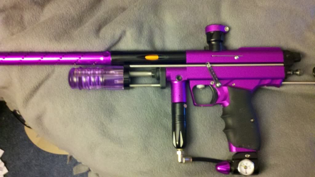

I just took apart my CCM almost completely. When i got it back together and put some air through it it started leaking. I was like wtf... found out that its coming from the screw above the reg. I just replaced the old gunky stuff that was on the threading and put some plumbers tape and its still leaking......should i use that liquid stuff? cuz it seems like thats what was on it before! its comin from both sides.... HELP LOL

check the o-rings on the pump kit and the one of the front block

The gauge port screw? 2-3 layers of teflon tape wrapped in a counter clockwise direction should fix that easily. Check the front block o rings and maybe put some Teflon on the pump kit threading. If youre not 100% sure where the leak is coming from

Hey thanks! Ya I was putting it on clockwise. And I was thinking of putting my gauge in that spot. So we'll see. Thanks!

teflon tape didn't work....so i looked in the manual on some website.
you need red loctite threadlocker worked like a charm! lol problem solved haha

I don't now if I would have used red loctite. If you ever want that plug to come out, you'll have to heat up the metal to melt the loctite. Blue would have sufficed.

Those don't ever really need to come out and that's what they recommended. Lol

as soon as i air it up it leaks air through the barrel again.... the other leak has stopped...i jus dont think i am putting it back together right or something....anyone got any ideas? i may jus call CCM tomorrow and see what their tech says

got it figured out...lol
