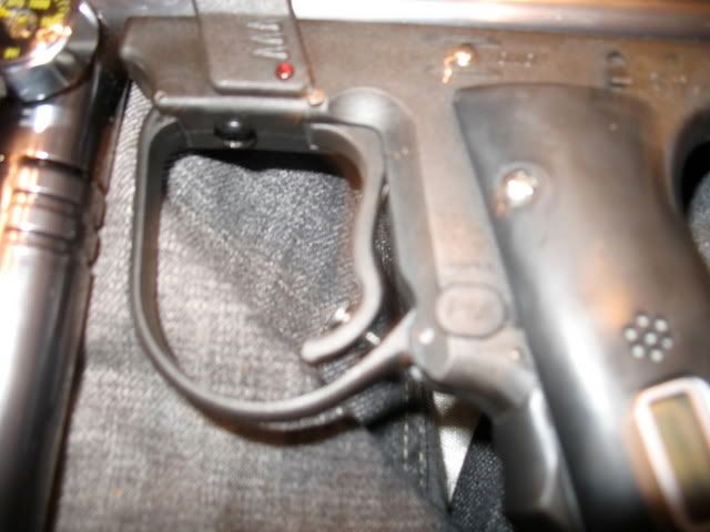

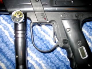

dremel'd stock trigger-like a straight line
i was bored again, so i wanted to mess around with my stock trigger. what i did is i used a dremel and i cut the bottom 'lip', shaved the trigger so it's thin and straight, and smoothed it with the sandpaper tool for the dremel. it feels really nice and consistent, but i haven't used it in-game yet, but i used it in the noid.
this trigger
to this trigger
EXWP is offline   Reply With Quote

sHoRtKid is offline   Reply With Quote
Old 03-06-2007, 03:35 PM #146
EXWP
I AM A MOTHER****ER
EXWP's Avatar
Location: 408
i made it out of boredom. i'm planning to get a blade
