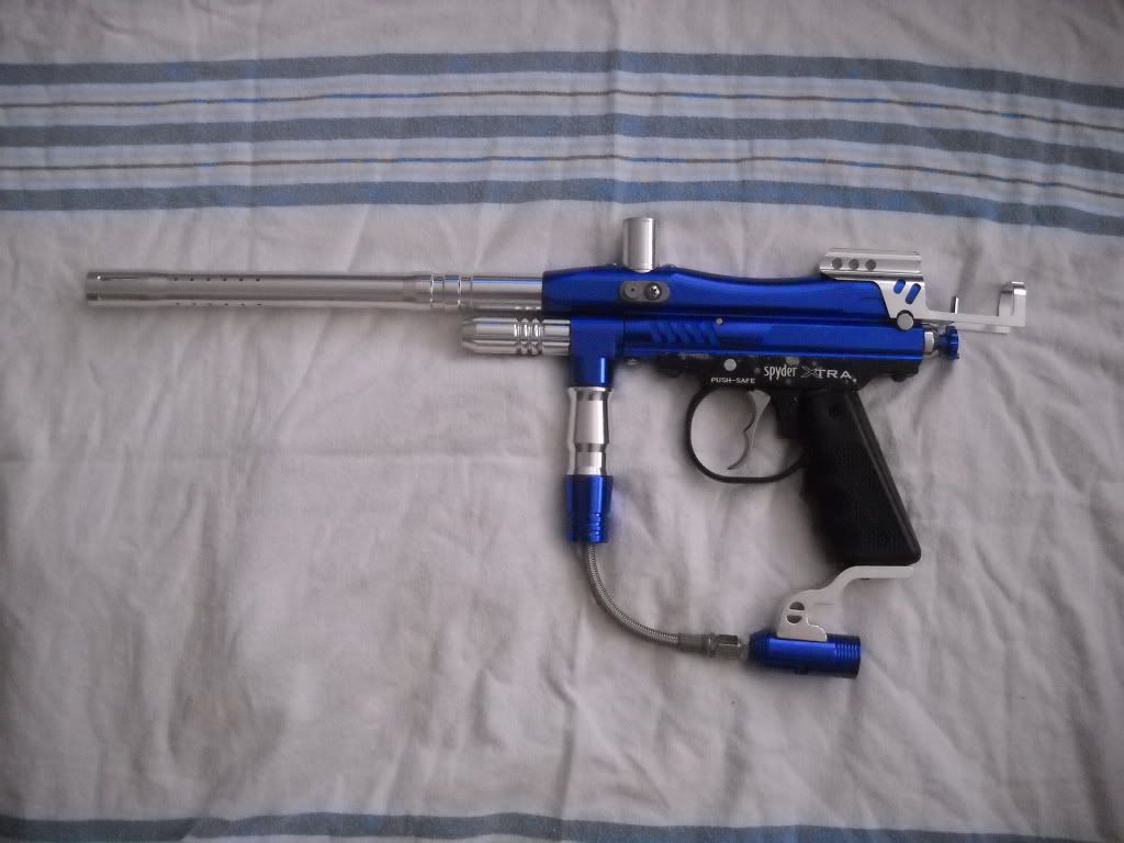

Can it be done? Thinking some of mech markers during same period
07 Sonic. Xtra.
