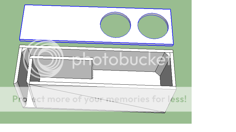

Anyone got any idea how much this would affect my tuning? The box (including the slot port) is 12" wide at bottom, and 10" wide at top. I would assume it's really negligible, but figured I'd see what you guys had to say about it.
EDIT: Figured I'd lose 24^3" of port from it being angled, so I could add a little over an inch extra on the port inside (1" increase would give me 21^3" of that back), but wasn't sure if the weird angled port would make things sound weird. Anyone know?
Also, is it a bad idea to have subs up, port back like that with a slot port, or does it really not matter?

I don't think you'll notice a difference with the angle. You can always calculate and make sure everything is still proportionate.
As far as subs on top, port on the side, a few things I was reading said that in certain cars, they gained a few dB just by changing to that setup from a rear/rear setup. It should be fine as long as the port has room to breathe.
