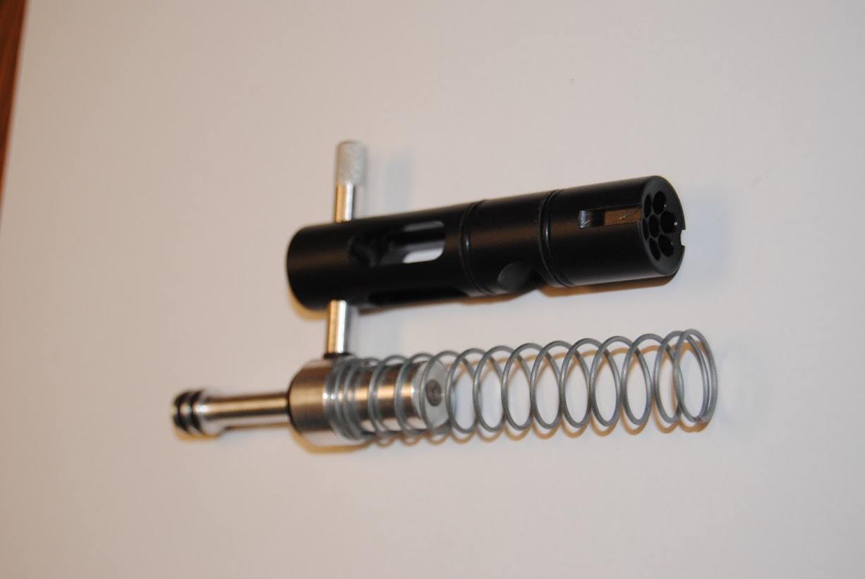

Rutley I received your parts today.
Snapped a few pictures when I got to my office at work to try and give everyone a little better look at them.
Just off hand I can say these parts feel super light (which was the point, duh) I will have a even better feel when I get home and hold them compared to my stock parts. The field I play at should be opening soon so I don't have any HPA to do full chrono tests yet but I have been running my markers off of my Air Compressor so I will be able to cycle the marker to get a idea of how the new parts feel.

The machining on those parts look great. If I'm not mistaken it takes 200-220 psi to get to 280-300 fps. I have a Rhino spring and think I have it set at 180 psi.

Hmmm, so can you PM me on the cost of the kit? I'd be down to do a comparison. The parts look way better than I'd anticipated.
What's the ram and pin made out of?

Has anyone really confirmed these work across all modes and if there is a notable efficiency improvement and not just feel. Seems like it went back and forth with reviews of works great to gun won't eve reach 260 and barely cycles.
Just to note, TechT kept the zero ping ram, hush bolt, and lo pro pin all the same weight as stock in order to maintain the same moving parts vs valve balance. Eigen has yet to release his g6r rammer primarily because he can not get the performance gains he wants due to lightening the ram causing more problems then gains. Same happened with gen 4 timmys. Lighter is better but when the whole system is designed to operate at one weight and you cut that in half and leave other parts stock it cam cause more headaches than it's worth.

it would not work for me. i had to raise the hpr over 50 psi to get it to chrono to 280 fps. and shooting in psp 12.5 it would chop like crazy.
