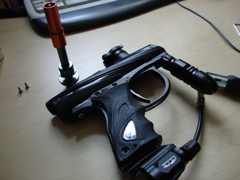

Multiple eXTCy questions =)
So i got an eXTCy this week and went to the field to try it today.. So initially it was shooting at a velocity of 240 fps, then i increased to about 290, shotted ok.. Then went a bit more than 300, and buff gun stared leaking air... lowered the pressure and leaking stopped.. So i left the gun around 290, while around 290 i did few more shots and the velocy was varying alot... 275, 290, 292, 280, etcs.. which made it very hard to keep hitting the same target. Was shooting at a 20x20inch square about 20-25 feet away from me and the paintball if hited the squared (missed few times) it would not be in the same place so it was not that accurate.
So i know i need a better barrel than the stock one.. I ordered the Full freak fit, (one with the 8 insert, back and 2 tops_
Also should i go ahead and upgrade to a 360 QEV? also should i upgrade the bolt and get the Firebolt from GoG, that way the velocity will be more consistent making it more accurate.
Also why was the gun leaking air at more when set at more than 300 fps?? (how to fix it?)
FYI my tank is a HPA ninja 68/4500

Barrel - The freak is a good barrel, it's what I shoot.
360 QEV - This isn't necessary, and in fact, if you use the bolt I'm about to suggest it's actually discouraged, as it will make your bolt cycle too quickly.
Bolt - I'd recommend getting the Deadlywind Hollowpoint bolt as an upgrade if you're really wanting a new bolt. The firebolt (along with 90% of Ion "upgrade" bolts out there) is essentially just another stock bolt.
As to your inconsistency/leaking issues: It sounds like your pressure is too high/dwell too low, or both.
To learn how to properly set your dwell/pressure, try this:
Originally Posted by ZDSPB
Detailed below is the suggested method for finding this optimal dwell setting for your particular Ion. This is how I set all Ions that go through the shop for repair. The setting may be fine-tuned later on, but this will give you a good starting point to use.
1. Pressurize your Ion at whatever input pressure you wish to use. I suggest between 140-170 psi, depending on the internals. The following steps involve dry-firing the marker (firing it without paint). Always be safe. I suggest a pressure that currently gives you about 275 fps
2. Lower the dwell to the minimum setting (or an extremely low setting, such as 5 blinks with the stock board, or 8 milliseconds with an aftermarket board).
3. Gradually increase the dwell setting until the marker begins to fully cycle. When the marker has trouble cycling, the sound of the bolt firing will be muffled and sound erratic, denoting inconsistencies. When you reach the point where it fully cycles, the marker will sound loud on each shot fired, with minimal sound difference between them.
4. Once the Ion is fully cycling, increase the dwell another 4-6 blinks (2-3 milliseconds with aftermarket board), and that will be your new dwell setting.
http://www.zdspb.com/tech/mguide/ion...ectronics.html
One more note: there is no reason to be shooting more than 300 feet per second. It is dangerous, and discouraged. It will also actually decrease your accuracy.
If you have further questions, just ask.

Right, dwell and pressure.
Dwell determines how long the valve is open, and pressure determines effectively how much air you're dumping during that time. If your dwell is low, in order to reach 300 FPS you have to compensate by making your pressure much higher than is safe for the marker - causing the solenoid to vent in order to protect itself. It also could cause the valve to close before the paintball has left the barrel - which makes your consistency depend on your electronics, and paintball electronics aren't very consistent. Also, know that most electropneumatic markers, and spool valved markers like the eXTCy, aren't really designed to shoot much higher than 300 FPS. You could easily damage the seals in the marker by attempting to do so, especially if you don't know what you're doing.
tl;dr - a short dwell and too high a pressure will cause the solenoid to vent in order to protect itself, as well as lead to inconsistencies. I recommend re-tuning the dwell and pressure of your marker.
Another likely source of inconsistency is bad paint and a bad paint-to-barrel match, but you've already taken care of that by grabbing the Freak barrel.

I honestly wouldn't take it over 300 fps. You can seriously injure someone at that velocity if you hit them in the neck, unprotected parts of the head, or other sensitive "areas". Not to mention paintball masks aren't rated for velocities higher than 300 fps, and the energy carried by an object goes up very fast as you increase your velocity. A 10% increase in velocity corresponds to a 21% increase in energy carried by the paintball.
If velocity adjustment is necessary, use a 5/32-inch allen wrench on the adjuster in the bottom of the
vertical regulator, turn clockwise to increase the velocity/pressure or counter-clockwise to decrease.
Take three or four shots after every adjustment to allow the gas pressure inside the eXTCyTM to stabilize,
then measure velocity again. Adjust until the marker is firing consistently within the limits for the field
where you are playing. For safety reasons, never adjust the eXTCyTM to fire at greater than 300 feet per
second (91.44 meters per second).
http://www.gogpaintball.com/docs/manuals/extcy.pdf
If you want to increase your range, you could get an Apex freak tip and an Apex2 barrel or something that adds spin to the paintball.
