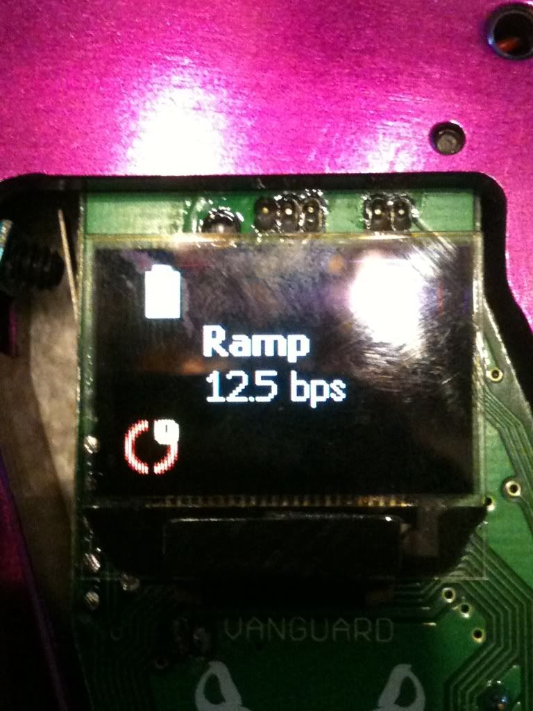

So my creed has been giving me a yellow circle with an exclamation point in the eye display area of the oledn screen when ball is in breach and trigger pulled it's in the middle where u would see a green circle for ball in breach. when no ball is in the breach it's just about the two halve circles to the right anybody know what this means? Here's some pics to help thanks

Try turing your eye sensitivity up to 15 when in psp. This happens when you are shooting at slower rates of fire. The functions within the boards need to be slowed down.

Thanks, what is it trying to tell me? Just interested and couldn't find an explanation any where.

That the eyes is still seeing an object once the cycle has completed. Meaning you slowed the marker down ( ramp 12.5) now you have to slow the sencing of the functions down to. All you have to do is adjust the sensitivities of the eyes to slow down how fast the board is trying to read a cleared shot.
