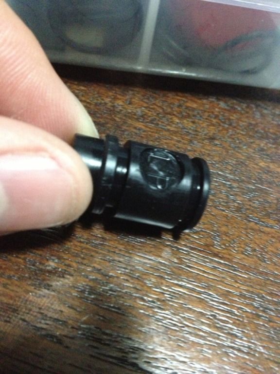

Originally Posted by Lt. Tank View Post
Just checked and there is no noticeable damage in the valve guide or the exhaust
any suggestions ?

Originally Posted by Jose1998 View Post
Hey LT, the same thing happened to me after I got the dart kit, my ego was leaking from the valve area, and I took it to a shop and hey told me they had to sand it a bit, even though there was no visible damage
Jose , how did it turned out ?
Did they end up sanding it ?
Yeah they sanded it and it never had a problem since I got it back
I guess I didnīt put the proper attention looking at the valve guide.
It has several nicks in the seal and close to one of the orings
Yeah my valve guide had a tiny scratch on it, so my local shop fixed it up for free since I bought the dart kit from them. Just take it to your local shop and see if they can do it for free because its actually something very simple.
Thanks Jose.
This is a used LP valve for a 09-11 so I think iīll try to do it my self. I got the regular MP valve installed with no leaks, but, really want to put the LP back in , the 09 shoot so smooth with that along with some really good fine tunning.
Anyway, gracias amigo !
The side your pinching should go into the body first. The other is the sealing side. See if it has any nicks.
done sanding it with 800 grid and NO LEAKS !!!!!
AS USSUAL THANKS
thanks Bill , thanks Jose
AS USSUAL THANKS
Glad I could help!
