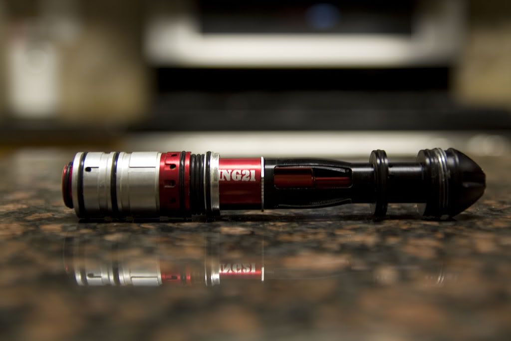

Anyone used it in a BW bolt? Any pics if so.

Originally Posted by slowimpreza View Post
Whoa, what happened to the tubing that is pictured on the website for the DM9-11? it's now o-rings stacked?
Thanks btw for the picture!
