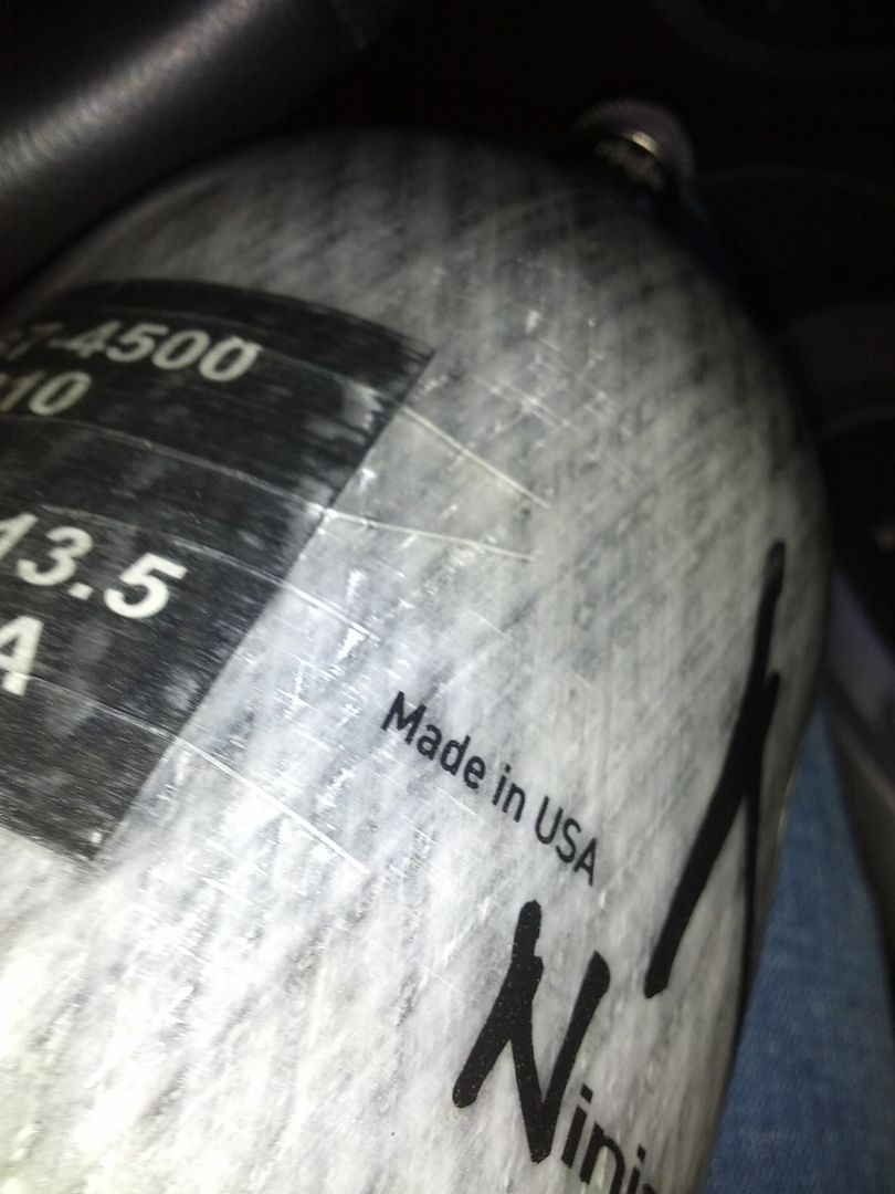

I have these cracks in my gel coat are these normal? I didn't see them when I first got the bottle but noticed them today. Only played with it once and filled 3 times never dropped or anything. It looks like stress cracks.
pushc6 is offline
Old 11-30-2012, 08:05 PM #1711
pushc6
Join Date: Jul 2010
I should mention I know they aren't a threat to the bottles integrity from what I've read, but I was just wondering if this is something expected or if it's a flaw in the gel coat? First time with HPA and not sure what constitutes normal wear.
pushc6 is offline
Hey pushc6. Its very rare for the grey bottles to develop outer gel coat cracks but if you want, you can definitely send that in for warranty work by clicking http://97.74.153.121/NinjaWarrantyTa...s/warranty.php
Unfortunately, these kind of cracks can develop on just about any manufacturer's bottle. You can google search on cracked pure energy tank, cracked guerrilla air tank, cracked empire tank you'll see that all of us have had this issue. Even though its 100% safe and doesnt affect the performance or safety of the bottle, send it into our bottle manufacturer so they can apply the new gel coat on the bottle for you. (no out of pocket expense to you)
Yea I saw it wasn't uncommon, I was just wondering if it's a result of a bad batch of gel coat or sometimes it happens, sometimes it doesn't "normal" kind of thing. If it was a result of a bad batch, then it may be worth it to send it in to get it "prettied up" again, but if it's something that could pop up again then I'm not sure i'll even waste the time since it lives with a bottle wrap on it most of the time.
It should not occur again unless you buy an older tank that might be prone to the cracks and has not already been sent in for warranty work.
Our mfr revised the gel coat formula and process and since the beginning of August, no issues on the new coating on warrantied tanks or new ones.
