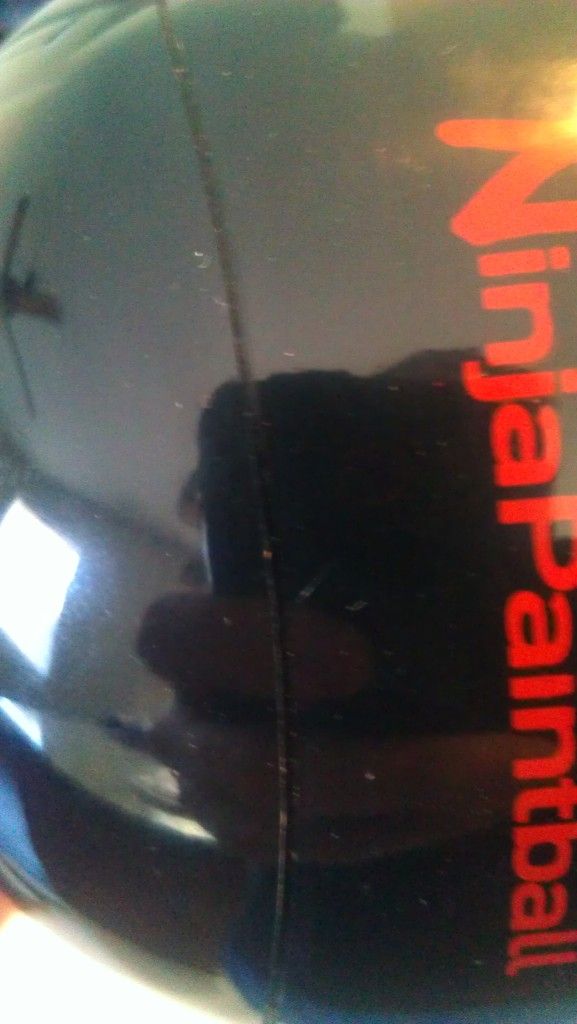

Hey guys, I pulled my 45/50 out of my bag yesterday to prep for today and found this. It's around the entire bottle. According to a non-ninja tech its something that can happen with varying temperatures and air getting caught and cracking the gel coat. I'm coming here not only for confirmation of that fact but more importantly either way is this something that is covered or at very worst can I pay to get this fixed? This tank has been used like 3 times and was bought 2-3 months ago I really don't want to have to shell out for a new one. Thanks for any info!
"Originally posted by martix_agent: wrestling knee pads is something i've not though about. where would I go to get those? Those would definitely be made for rubbing against the ground and taking a pounding."
Dagger8805 is offline
Dagger, you are experiencing the same thing that many of us have been. The tank is still safe to use since the crack is just in the clearcoat. I sent my tank back a couple weeks ago and it took less then 10 days to get it back with a new clearcoat. Use this link and Ninja will take care of you.
This is 100% safe and does not affect the safety or performance of the regulator. You can get it warrantied through www.ninjapaintball.com/warranty
Follow the instructions at the top and click the Bottle Warranty Link. Follow the instructions on the next page, print the UPS label, box her up and send her in. Normal turnaround time to remove the old gel coat, apply and cure the new formula, mount your original regulator, and ship will take about 3-5 business days.

Hey guys so here is the story:
I was lubing up the bolt on my paintball gun and then I went to grab my tank and i feel I may have put a tiny amount of lube on the face of the fill nipple. I am not completely for sure about this. I took a flashlight and looked for shininess on my fill nipple (It is dust silver) and I didn't see any. It has no air in it. Should I be scared or not? Please E-mail back as soon as possible!
