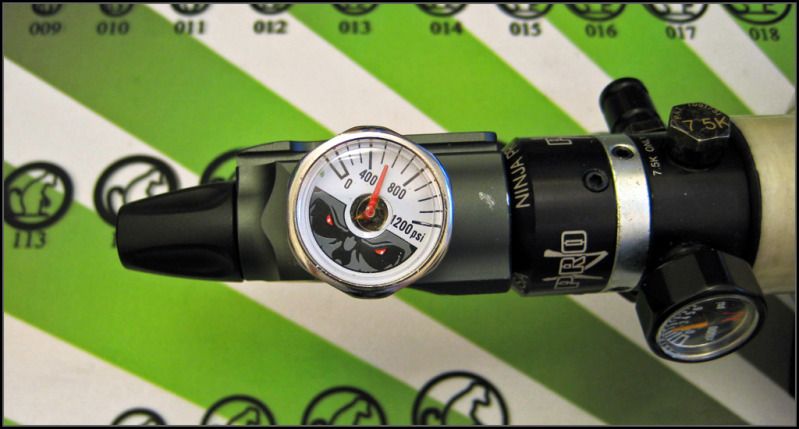

Originally Posted by f8al View Post
Hi Andrew
Regarding the Pro reg being at 590-600 with 2 shims out, have you tried cleaning your reg? I just tested mine and I am at about 560 with 2 shims out. Also, what kind of gauge are you using? Most standard gauges have some variation in them, but the liquid filled ones (like on a fill panel) are far more accurate. Just trying to clarify/troubleshoot your issue here. Let me know if I missed anything
So my Pro-reg has about 3 fills now and it's reading 550 PSI. Maybe a slight break-in period?
MugenR is offline

I would think that they would have a slight break in. And error from a gauge is probably higher than the break in change.

Originally Posted by MugenR View Post
for the pro-reg. I have not cleaned the reg, but it's brand new. that was the first fill. I'm using a standard regulator gauge I pulled from a bob long torpedo. It seems to be accurate as it's reading the SMP550 at 550psi.
Hey MugenR. I have a feeling that gauge may be a little off. Tank regulator gauges are known for not being the most accurate gauge you can use for testing. If you're going to be at one of the national events, you can bring the regs by our booth for a quick pressure check to see what our certified gauges read. Also, when we state say 450, 500, 700, or 800psi, there is a +/-25psi variance in either direction, so if that gauge is reading around 590 with two shims out, that is pretty close to the 550psi output we describe in the manual, taking into account the +/-25 psi variance in either direction.
no, no break in period. If you're going to test a regulator, please use a CERTIFIED gauge and not a gauge that's old that you pulled off of a tank regulator.
