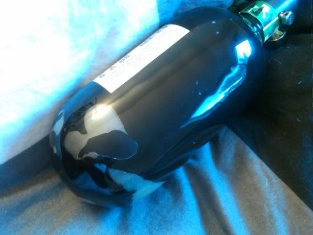

Originally Posted by theTEASE` View Post
There was tape on this tank so I took it off and it stripped off some of the gel coating placed on the tank. I wanted to send it to you guys to hydro. I want to know if it'll be good for the hydrotest and if it will be good for play, thanks in advance.
Pic below :
100% good for hydrotesting
100% good to play with
The black coating is there for cosmetic reasons only. It does not affect the performance or safety of your air system.

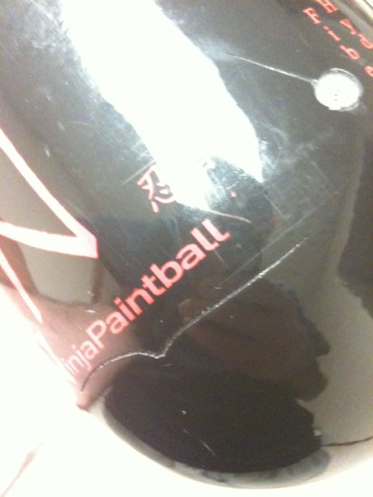

It looks like my 68/45 has a crack near the reg...you can feel it with your finger. I can't tell if it's just a crack in the resin with dirt in it or what. It goes about halfway around the neck of the bottle. The tank is fairly new, I bought it a couple months ago from ans. I've never dropped it, landed on it, etc. It may be nothing, but better safe then sorry.
EDIT: Added better pics
if you turn your camera to macro mode you can get close clear pics. ITs the one that looks like a flower. just a fyi

Thanks, I just took some with my iphone and they came out way better. I put them in place of the old pics. Sad, I know, my phone takes better pictures than my camera.
PM'ed

Just recieved a ninja 50/45 in a trade and the black coating on the tank has a chip and a crack. It doesnt look like the damage has affected the clear resin or carbon fiber wrap. I was just curious if this crack/chip would affect the integrity of the tank or if it was purely cosmettic. sorry if this is a repeat question.
Thanks in advance.
how would you like a new bottle?
email me those pics to rob@ninjapaintball.com and include your full name, shipping address, and phone number. I'll get back to you as soon as I get your email.
