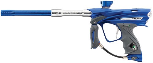

Evolution of the Dye Matrix
Grouped generations of Dye Markers
(See conclusion and chart at the very bottom for tl;dr)

By 2012, the Dm can be considered a "taller" marker.
While the grips are comfortable, they tend to wear quickly

Dm13
Pros
Hyper 3 w/ angled collar
Tool-less Bolt design
NT hyper 3 cover
*Milled windows
fuse bolt has a large boltcan, which improves consistency in firing volume of shot
Contact pads
Lpr preset to 75psi
Ultralite 2 Frame
Tooless grips
NT ASA
lpr design
Button Pad
Hyper 3
2 trigger adjustable side screw
2 dip switches
battery powering directly towards board.
Locking feedneck
eye pipe system
Ironmen ultralite Trigger
Color coordinated orings
Fine board adjustments
*New series of colors and pga designs
Cons
Dye dm13/12 value drops very rapidly due to the minimal change from 2012 to 2013.
Conclusion
In conclusion if we look at the evolution of the Dye Matrix series we see a progression of change in nearly every group except for the LPR stock settings. In all fairness the Lpr's true value is usually dictated not by a set number but by the HPR and dwell. Although the original chart is deceptive in showing a minor change from the dm11 to dm12, if we base change from the DM4 to the DM12 we see that there is a change in every sector save one (as seen below). The Dye Matrix has gone through continual change from 2004 to 2012 making it one of the top performing markers today.
