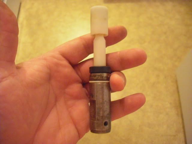

Make me bust mine out. . .
Threw on my CCi .45. . . way more comfy .
Funky bolt/hammer combo too.
