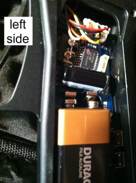

I have had my Drone DX for a little over a week now and got to use it in real play this past Sunday. It's pretty new so it needs to be broken in. Otherwise, it is a nice gun. If I didn't need to test a PMR I just fixed, I would have shot it all day. The only adjustments I have made is the velocity was running 250 and I had to turn it up a little. After shooting it for a few hours, I adjusted the trigger to make the pull a little shorter and lighter. That was purely preference as it shot perfectly otherwise. I had no problems with FSDO or velocity problems of any kind. It was ball on ball every shot.
OK to the real question...
I pulled out my board to try to find any indication of what is the correct orientation. There is no indication that I saw on the board what the correct orientation is. Since the gun came with a macdev battery installed, I turned it on and tested the solenoid to confirm operation. I then made a label with "+ -" on it and stuck in on top of the capacitor which is just above the battery clips. At least that way I will know what the correct orientation is. Next I looked for some sort of protection diode so you can't get power to the board and didn't find anything. I will look again, but my cursory search revealed nothing. The capacitor mentioned in an earlier post was possibly weak to begin with if it blew immediately, but electrolytic capacitors are NOT supposed to be connected backwards. I have been an electronics hobbyist most of my life and have blown up a few caps by connecting them backwards. They will last a little while depending on how much voltage they are rated for, but eventually they will blow. A single diode added to the board would have completely eliminated the possibility of a blown cap. 4 diodes connected in the right way would make it impossible to install the battery backwards as it would work either way. There would literally be no backwards.
To fix the problem would require some re-engineering of the board so it would work on a lower voltage. As it stands if you add protection diodes the board is going to think the battery is too low to operate the gun. Just put a small label on top of the capacitor so you know which way is the correct orientation.
OK Maccev...
One solid MEH! for not making this more fool proof. The components needed would have added a couple of cents to the cost of the board. Or how about a sticker on top of the cap showing proper battery orientation.

My board is marked + and - quite small print, but it's there.

my drone shows me the battery orientation when i take the rubber grip off.... its on the other side.... making it very clear for me....

Positive is on the right, neg. is on the left with the left grip panel off. The markings on the left side of the board are partially hidden by the capacitor, but they're there.
