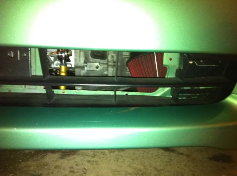

Is it a track car now? How far off the ground is that intake?

its more of a track car then ever but its still a "street car". itll be driven to the track ect and for spirited street driving.
the intake has plenty of room. its right in the air flow path.
