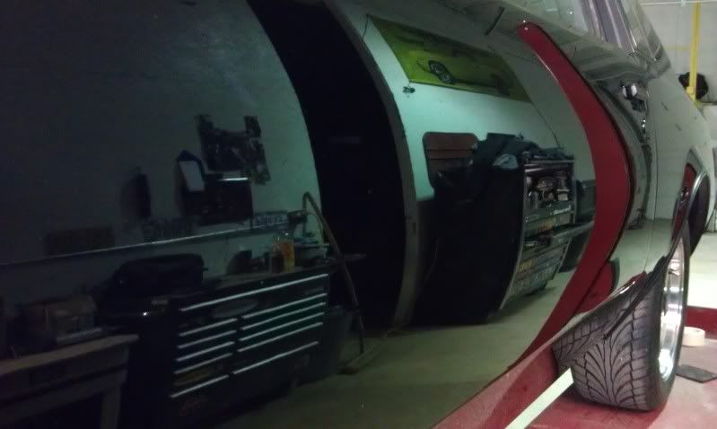

Detailed the car yesterday. Finally had a chance to get rid of the spider webbing from the damn dealer "wash" which I specifically asked them not to do.
Wheels:
Sonax and pressure washer*
*No brushing as I will be bedding new brakes in this week so there's no point in getting them too clean
Wash:
Wash with Adam's APC
Exhaust tips cleaned with Adam's APC and a flexible brush
Clayed with Uber gray clar bar
Dry with waffle MF towels
Polish:
Meguiar's M105 with PC and Uber green pad
Meguiar's M205 with PC and Uber blue pad
Hand polished clear bra with Meguiar's PlastX
LSP:
Wipedown with IPA
Applied Aquartz Titanium (cool stuff) to paint and glass
Finishing:
Dressed tires with Adam's VRT
Treated window trim with 303 Aerospace
Polished and protected exhaust tips with Einszett Metal Polish and Wax
I'm going to put on a layer of Collinite 845 then Autoglym HD next time I wash. I wanted to let the Aquartz Titanium cure for as long as possible so I skipped those.
And, of course, pics:
