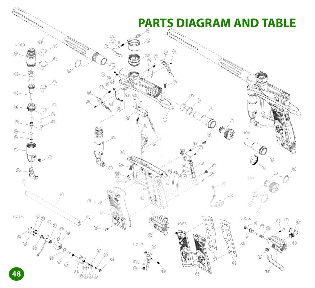

Shown Bellow is how the Fusion FX works. The picture is of a Fusion f7 but the design is the same.

Fusion FX Tear Down Guide
If you Currently own the Fusion, Im sure you are pretty interested in how to tear it down and properly maintain it. Luckily for you, I put together a little guide on how to go over everything from the bolt down to the solenoid.
