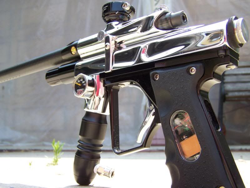

Now you're ready for a gun. buy used, saves you loads of money and you get super high performing markers (what we call guns) for the same price as a new low or mid-grade marker.
There are 2 main categories of the higher end markers.
1: Spool valve (Dye, Proto, Smart parts markers excluding the impulse and nerve, Dangerous Power excluding fusion, and Hostile Creations) these are markers where all the functioning and moving parts are concealed inside the marker. They're smoother, quieter, and the more efficient ones cost more unless you're going to be upgrading them. These are generally higher maintenance, but are also lighter and most often have a lower profile than a poppet (excluding certain Inline-Poppets like the Mini or gen2 Marq). Spool valves are naturally an inline system where the valve is behind the bolt in a "sleeve". Spool valve markers typically require synthetic or Dow33 based Grease and must be cleaned and relube after every case of paint or two to maintain its internals. ALSO: Dump valves like the Dangerous Power "G" Series and the Planet Eclipse Geo Series are basically dumbed down spool valves. They tend to be far more air inefficient, but are simpler to build and maintain for that matter. They are also far more durable to stupidity.
Examples of spool valves:
Smart Parts Ion
Smart Parts Shocker HE bolt
Pre-2k7 Dye Matrix Bolt System
DLX Luxe (Actually initially made by Smart Parts. Uses their regulator and design of an "updated" Shocker bolt kit)
Dye Matrix
MacDev Droid
Eclipse SL91 (on the left. It was designed to be the SL91, but was cancelled, then later turned out to be the Eclipse Geo2, which is still the simple dump valve that the Geo was, but with a sprung propshaft, or guide, and a much higher quality bolt system)
The SL94 is a Stacked tube poppet valve (shown to the right)
2: Poppet valve (Egos, Intimidators, Marqs, Invert Mini/Empire Axe, Alien remains, Independence, Dangerous power Fusion series, Mokal Aura, etc.) (Bob Long makes inline poppet valves, which also have concealed bodies, they are called the Marq Series). These markers are typically louder although more consistent (tighter shot grouping) as well as efficient (more shots per fill of an air tank) stock. They are much lower maintenance, but still need to be lubricated and have more parts to take care of as the system is naturally mechanically assisted. Poppet Valve markers usually tend to have more "recoil" or kick, and have far more parts inside than a spool, ie; Springs, valve stems, cup seals, Rams, and bumpers, etc. ALTHOUGH poppets are still incredibly durable when maintained properly and not thrown into a tree, ocean or volcano, with lack of proper maintenance, they will fall apart on you. Poppets also tend to have a lower resale value than spools for the most part, so if you want a quality gun for less, best bet is getting a poppet. (EXAMPLE ONLY) An ego7 (2007) runs for about $275- $300 when a dm7 runs for about $280-$320.
How a typical poppet works.
LPR (Low Pressure, or Horizontal Regulator): Supplies air to solenoid and Ram (the thing that moves the bolt). The lighter the ram, the higher your pressure will tend to be (to a certain point) when dropping it in. As the spring breaks in, you can lower the LPR. All markers (exc. cockers) have LPRs which typically should be kept below 100psi. A consistent LPR helps with preventing paint from being chopped and your marker from shooting inconsistently.
HPR (high pressure, or Vertical regulator): This supplies are to the valve which then escapes through the bolt and behind the paintball. These are vital for a consistent shooting paintball marker.
Ram: the metal stick with bumpers that uses air and/or springs to move the bolt (that's attached from above) forwards and backwards, thus cycling the paintmarker.
NOTE: Tippmanns are also poppet valves, they go under the "inline poppet" category, where the bolt is in front of the poppet valve instead of on top of it, and in this case, the Tippmann markers (except the X7 Phenom) use a power tube and hammer instead of a ram-poppet system, which is like a more durable and more simple version of a ram.
Examples of Poppet Valve Markers:
Clockwise from top right:
Angel 06 Speed, Heavily Modified Tippmann 98 Custom, Mantis Ego framed WGP Orracle (which has been mid blocked), WGP Karnivor
Destructive Customs milled MacDev 2006 Cyborg
Infinity Legend
WDP Angel AR:K
Debounce1's Liquid X mill ICD bushmaster
[img][/img]
Immortal Viking with Ultralite frame
Autococker Valve System (Stacked Tube, Closed Bolt)
Eclipse Ego System
Invert Mini (Pressure Controlled inline Poppet)
3: Pump Markers (Snipers--cockers converted to pumps, Phantoms, Metadyne Pump, Sanchez Machine SM-1, Palmer's Nasty, Punisher's Phantom, Nelspot 007, PGP markers, STP markers, ACI Maverick, both Trracers, TigerShark and so on...) Sniper pumps are essentially a manual operated poppet valve in its purest definition. They replace the cocker's pneumatics (ram, Low Pressure Regulator, and 3-way or Solenoid) in the case of a cocker and put a Pump handle in place of that which attached to the pump arm, pushes the back block backwards in order to cock the marker for each shot. All pump markers work this way, except the way they are designed to perform that action are slightly different. With Phantoms, Punisher's markers, Palmer's pumps, and markers of the like function by the Pump motion pushing back the bolt, which allows air through a valve, which is stored behind the bolt when it is pushed forward into firing position. When you pull the trigger, it trips a sear, which then opens the valve and releases the air through the bolt and out the barrel behind the ball.
Single tube (body) pumps are "Nelson Style" and Stacked Tube (1 over the other, like many shotguns) pump are considered "Sheridan Style".
Pump is far more economical, the markers will also last MUCH longer than spools OR mechanical/electronic poppet valve markers. The maintenance on these are almost zero, this style of play will lead you to be more accurate as well whenever you switch over to a semi/full auto marker. Why play pump? Well, it's damn fun and is full of soul
Chipley Machine (CCM) S6
How a pump works (PGP as an example)
FBM Krusher Sniper with a White Wolf Airsmithing (WWA) Pump kit and Hybrid Quest Numatix Frame and accessories.
ALSO: Cockers are poppets as well, but different kinds of poppets. They are still a stacked tube poppet like the ego, but they have a closed bolt operation (bolt is all the way forward, sealing the ball into the barrel of the marker, when it fires, it shoots, cocks the gun, then seals off and shoots). This makes it more susceptible to rollouts so a smaller bore barrel is necessary if you want the paint to fly at your opponents and not a couple inches in front of you. Cockers have the cocking solenoid on the OUTSIDE of the marker, on the front block. The front block ALSO holds the Ram and LPR in place as well. Cockers can be incredibly consistent and efficient markers, but take a bit more time and energy maintaining and tuning them. They can be quiet and smooth like a Spool valve, yet have the efficiency and durability of a poppet.
