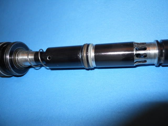

How longs should springs last? Today was my first practice with the rhino spring, it was great. Shot ropes all day and I noticed to get a couple more pods off of it. Only thing was in the beggining of the day I would shoot thins the spring would "catch" and not fire, so I tried the other spring and it worked perfect.

never herd rhino springs failing over time. as for binding in the beginning could be from incorrect bore size on the bolt

but my other rhino spring I put in worked great? I was just wondering because I thought it was odd. But I am very happy with it

Catching, it MIGHT catch or "bind" on the back of the bolt guide. SP bolt guides and aftermarket bolt guides are notorious for having different OD dimensions! A little light sanding of the BACK of the bolt guide is all that is needed usually...

Thanks rhino I just relubed my gun and my spring has to be pushed on the bolt guide a little. Should I shave the bolt guide so it just slides by itslef pretty much?

Did you just use sandpaper or what strange? Your spring just slides on smooth?

i have a lathe, but sanding with some good old 180g and 250g sandpaper should have you done in about 15mins
EXACTLY THIS!

or if your bolt has the correct counterbore it should work as well.

Some bolt guides just suck. The bolt you did hung up on my hybrid guide until I sanded it down, it seemed to have a much larger lip than stock.

yeah, the hybrid guides are larger than stock. I though i had sized the counterbore to account for them as well, but I guess it's still not large enough to fit the differences in tolerances for them.
