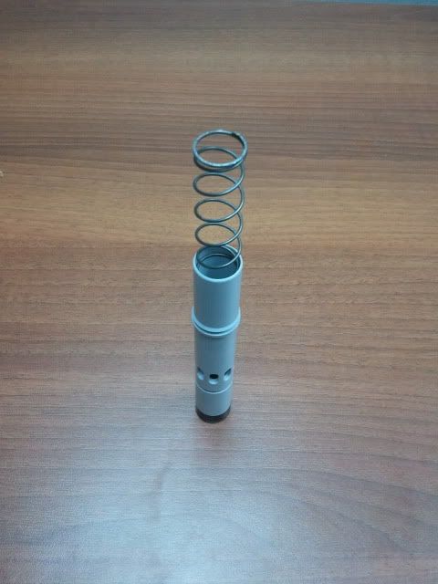

When you say that the bolt protrudes in to the breech area, is this when the marker is gassed up, or prior to airing up the marker? If the latter, then this is perfectly normal for a sprung bolt Shocker.
Thats with air. Without air I understand the bolt is foward due to spring pressure. It protrudes approx 1/4" inch. That's why I had to cut the spring because it would not me to load a ball into the chamber.

Indeed. you shouldn't ever need to cut the spring.
I had to. Look at my picture, I machined the bolt according to the print provided and purchased the spring from rhino. If you count my coils my spring is longer than the pictures strange provided in the previous thread of the "spring mod v.2.
Strange's pictures with springs - I don't know what spring he used but i'm going to speculate rhinos. Sorry for the picture hijack, only using for reference.
My spring

I'm thinking you mill work on the bolt wasn't done deep enough on the back end. You should NEVER need to
Cut my spring!

Originally Posted by b20btec View Post
My spring
your doing it wrong. the spring should be inside the bolt by 1.20" your picture clearly shows the spring only in maybe .25". Looks to me like you added the counterbore, but forgot to bore out the main cleance pocket.
Cut my spring!
Maybe so but I did it according to the print provided. I used a lathe to do the inside dimension work. Not saying anything bad, I'm just stating that I cut the spring to get it to work. I'm sure the spring tension is off now but marker shoots fine.
You're right. Whenever I have time I'll probably order another spring from rhino and bore it out again. The marker shoots fine as of now so I'll probably leave it alone.
