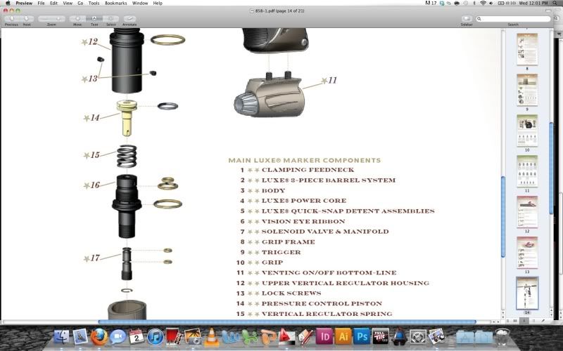

So the gun is leaking from the "lock screws", I have changed o-rings that I thought might be the problem, no luck.

I took apart the whole reg and cleaned/lubed and replaced o-rings per manual instructions. it leaks unless I have the pressured screwed all the way down

You can not develop a leak at the reg housing set screws.
I believe that you mean you are leaking at the reg adjustment screw. Did you remove the snap-ring and remove the adjustment screw during you tear down...or did you tear down to just the piston?

its coming from what is described in the manual as the "lock screws"

There are only 3 sealing o-rings on the lower reg housing. One of those must be missing, and or torn up. Probably the smaller of the two outer o-rings. Nothing else would cause a leak around the locking screws.

check the area around the bottom of the piston, if it is scored up or galled, it can create a leak thru the set screws, the leaks at the set screws can be caused by a bad piston itself (#14 in the diagram), the top piston oring or either of the bottom 2 orings. The set screws actually should be loctited in with BLUE loctite when installed as the set screw should not be overtightened which can distort the housing.

I've had this problem before and the piston oring will need to be swapped out. Check your reg seat for good measure.

so.... turns out it was the o-ring inside the reg housing (#16)
looks like i put a bad one in there when I changed them out
all is well now, thanks for your help guys, i feel dumb since it was just an o-ring
