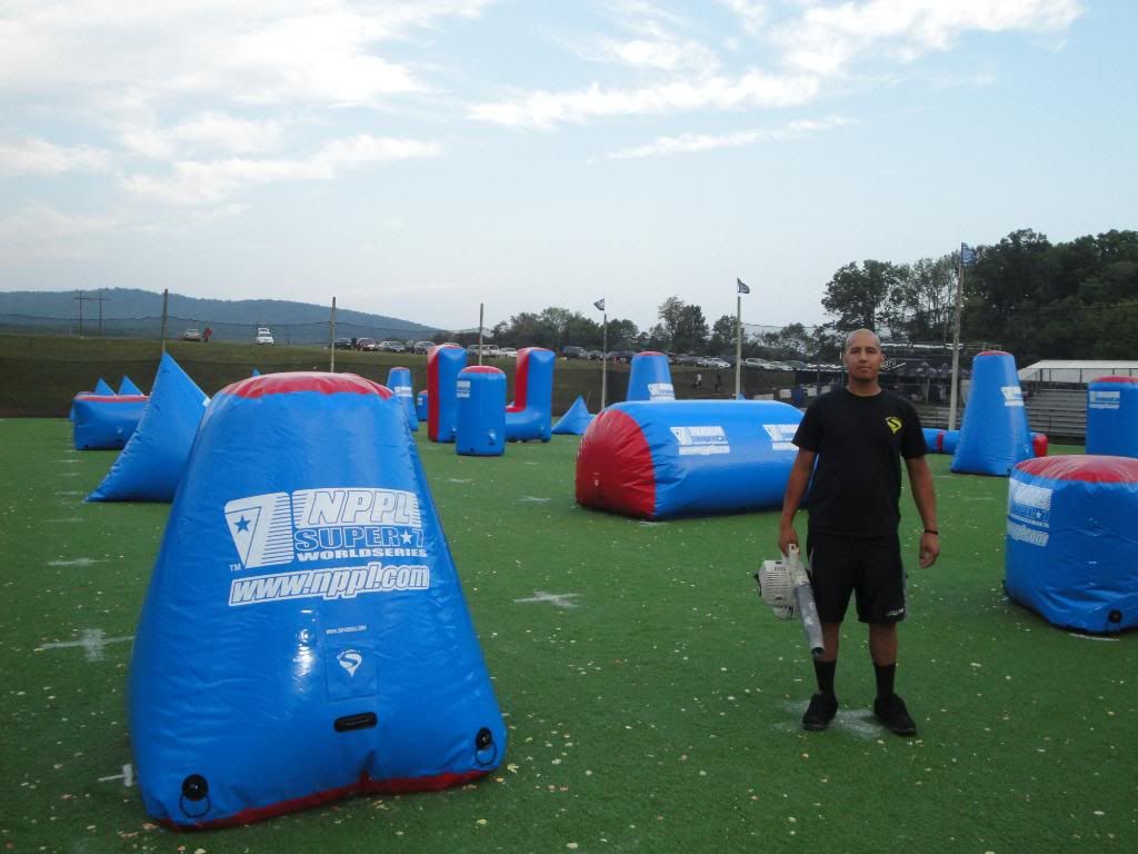

bunkers 101: setting up/teardown of sup'air pro series bunkers
the highest end of the sup'airball line of inflatable bunkers is their pro series bunkers. in addition to all of the other features it shares with its bunker siblings, the pro series bunkers have a separate chamber on the bottom of each bunker which allow you to fill the chamber with water. this allows you to set the bunkers without staking them in-perfect for fields that have turf installed, or even on grass fields as an alternative to using (and ultimately losing) stakes.
here is a short tutorial on how to properly set-up these bunkers for use on a paintball field:
1. unfold each bunker and place each individual bunker in their general, final position. for example, put all of the snake beams on one side of the field, the center piece obviously goes in the center, etc. this will reduce how far you have to drag a bunker filled with water to get it into position.
2.flip the bunker over so the bottom of the bunker is completely visible. do not leave any folds that will hinder the flow of water into the bladder.
3. remove the white cap and plug from the bladder valve.
4. begin filling the bladder with water. using a hose without a nozzle attachment is fastest. you want volumes of water, not pressure.
5. raise the valve a little bit off the ground. this will help in filling the bladder to its maximum capacity.
6. fill the bladder completely with water. you will be using about 5-15 gallons of water in each bladder, depending on the bunker. the bladder should be taking on a 'rounded' shape and should have a minimum of air inside the bladder. replace the cap and plug quickly, to reduce the amount of spilled water.
7. carefully flip over the bunker to expose the air valve. tip: the air valve is always on the same side as the water valve, and vice versa. do not 'plop' down the bunker as you flip it, or you risk blowing out the bladder. remember: water bladders are not covered under warranty.
8. fill the bunker with air as normal. FOR POSITIONING PURPOSES ONLY, you can slightly overinflate each individual bunker to make it easier to move around. once positioned correctly, remember to deflate accordingly!
do not leave bunkers over-inflated for long periods of time! overinflation is one of the causes for premature bunker failure (too much internal pressure). when using the water bladders, over-inflating the bunkers will cause them to go 'round' on the bottom, resulting in less surface area in contact with the ground. less surface area=the bunkers will get knocked around easier and get moved out of place. the ideal inflation for any bunker is to inflate it until the bottom of the bunker just begins to lift off the ground, then stop.
9. the pro series bunkers also have a handle installed to assist in positioning. many people use this handle incorrectly and inadvertently rip the handle from the bunker.
the best way to use the handle when moving bunkers is to tilt the bunker so that a maximum amount of bunker is lifted off the ground, then pull the bunker into its final position. remember: the air valves always face the nearest start gate!
10. cheats: you can 'cheat' on completely filling the snake beam bladders with water. these things get incredibly heavy once filled, and all that weight isnt necessary for a bunker that doesnt really get bumped into that much. i usually fill each bladder to about 60% capacity so i am not breaking my back trying to position the beam.
11. setup takes me 4 hours average time from start to finish, with 3 helpers.

teardown
teardown of pro series bunkers is as follows:
1. remove the water first before removing the air. pull the water plug and cap from the bladder and allow the water to escape. leave the air plug in at this time.
2. tipping the bunker over will allow you to remove more water from the bladder. pushing on the bunker will remove even more water.
3. once all (most) of the water has been removed from the bunker, remove the air plug. position the bunker in such a way that, when deflating, it will not fold over on itself and prevent air from escaping. this usually involves putting the bunker on its side. doritos, you can just leave as is.
with the NPPL carwashes, flipping them over completely will allow the bunker to fully deflate without the bunker folding over on itself.
the flaps on the valves hold back the escaping air from the bunker. i place the corner of the flap on the center of the velcro strip to keep an open passage for the air to escape.
4. once deflated, lay the bunker flat to eliminate any trapped air as we proceed to the next step.
5. if you are placing the bunkers in transport bags or just want to store them using the smallest space possible, you will need to fold them. the goal of folding bunkers is not to make a certain shape, but rather to have the valve be on the outside of all the folds, every time you make a fold. this way you can stand/sit on the bunker as you are folding to remove more air. folding the bunker with the valve on the inside of the folds will result in futile efforts to remove trapped air pockets.
and
you can also use a vacuum to suck the air out of a bunker. replace the cap after vacuuming to prevent air from rushing back in.
6. transport bags- i can fit between 8-10 bunkers in a single bag, using these methods. i can fit more if i used a vacuum to deflate, but i realized the bags became too heavy to move around. i try to keep the same shape in the same bag, and the big bunkers will get their own separate bag (for NPPL, that means 2 carwashes and the center piece). i use 6 transport bags for each field.

excellent, but 4 hours? holy ****. And don't you wash the bunkers before putting them away? Or is this just from a uspl event where the bunkers are sold after the event?

Those bunkers look like they were washed, just not the bottoms.
i am usually setting up for national level tournaments, so i have to use a little more scrutiny when placing bunkers, and i have to ensure that the water bladders are completely filled so that they do not move out of place during the entire tournament weekend. setting up a field with stakes is a LOT faster; i have averaged 1.5 hours per field using stakes. and 10 helpers. the most time consuming process with the water bladders is filling them with water.
these bunkers were hosed off before i packed them. there have been times where we didnt have this opportunity, and i packed up the bunkers completely caked with paint.
