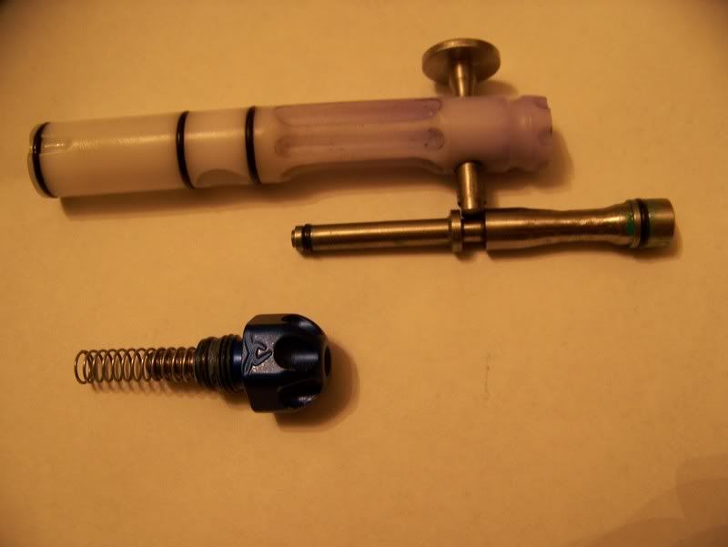

THANK YOU !!!!!!!!!! ive been needing one of these for a couple of days now .
ive also done a few things to my gun to get it to run like i want it to ......mostly kick related stuff .
i shaved my ram a little and did some moddong to my bolt . i ordered an ego pullpin and thats gonna help with weight as
far as the bolt goes .
i also put in a helper spring ......at the ram cap area . this setup isnt any different then the other guns ive run . the spring helps with dwell, lowers dwell because a little of the effort needed to move ram is gone . works great so far . now im workin on a feasable fix for those crappy detents . asides from buyin extra hard ones . findin a mod is the fun part, buyin a mod isnt ....lol . heres pics . i also cut the sring a little that holds in the detent for the pullpin, and shortened the hex head screw, it was just extra added weight . i have an eigenram, but we all know what needs to happen for those to work right . i will figure that out too....an easier way i promise .
