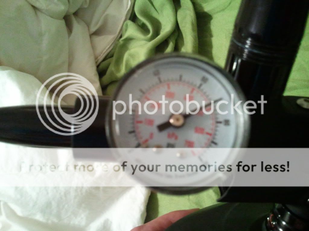

Just picked up a g6r from Zack and dropped in the lp poppet and shoot a pod through it and played with the pressures some. I will play with it some more this weekend at the field. After I get 10-15 cases throught it I will repost results. The marker has the same kick as my ego11 on setting 2/7, the luxe is still the smoothest marker made. Has nothing to do with the thread but the bob long pump is o so close.
-g6r (brand new)
-slp tank (output 278psi)
-lp poppet
-4c laser eyes
-pillow bolt
-.685 barrel
-evil paint (around .680-.682)
hpr 180-85 lpr 69-72
Chrono numbers
287 285 288 280 279 279 285 285 287 288 288 289
