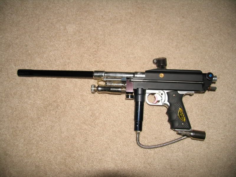

I had a rf cocker set up as a pump but i got a new one and i decided to convert it back to a mech semi for my dad. Anyway
When i received the marker it was a fully functional semi i took the pneus off and put on a pump. i kept the pneus in a bag its been about a month and i put them back on and apparently i failed miserably. when i air it up it leaks from the pneus. here is a picture of the gun with pneus so you can get an idea of what kind they are.

Where at from the pneus?

no one is helping from mcarterbrown and i put my hand right next to the guage under the big part and thats where i felt the airflow. and its alot

Is your oring on the screw that attaches the front block to the body?
All hoses nice and snug.
I'm not trying to make you sound dumb, just trying to go through the easy **** first.

lol bro. as of now with cockers i am dumb i dont think there is an oring there. good thing i have spares brb im going to go try that. thank you.

Also, when you locate an o-ring, make sure you put a film of grease all over it, and make sure all of the surfaces it comes into contact with are clean.

Make sure your hoses are on properly. In the right order.
