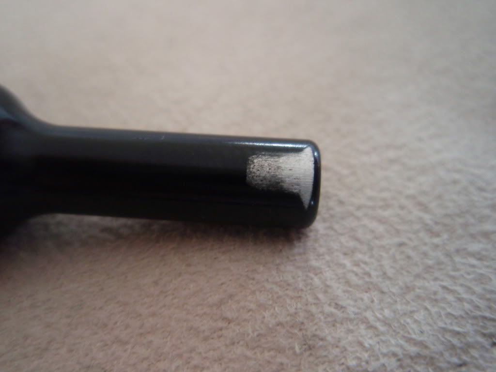

When I took it apart today I notised some wear on the tip of my propshaft

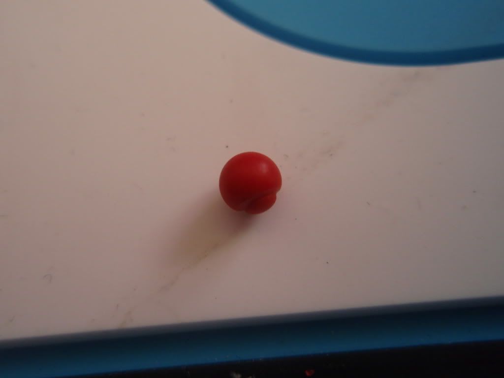

And also my back check ball has a ring on it, don`t know if it is supposed to be there or not but it looks like the spring sits into the groove.

It used to be stated that wear on the Prop was due to the #010 bumper o-ring not stopping the bolt rearward movement soon enough, and that you should use a #011 o-ring instead - it's now the o-ring that is used out of the box I believe.
However, since that time, it has been found that some Propshaft tips have been a touch crooked, leading to the bolt contacting the Prop, and causing the wear.
Try a new bumper, and if that doesn't resolve the issue, contact a PE service centre about getting a replacement Prop.

Hi,
The wear on the tip of your Propshaft is nothing to worry about and will not adversley affect your performance.

The back check ball is 4mm, but when I put it in there is not enough tension on the spring so the ball floats around alittle.
is the ball supposed to have the little ring on it?

If the ball is 4.00mm or larger (though between 4.00mm and 4.10mm is optimal), then that should be fine.
The ball will tend to have a slight seam right around the middle. If you are referring to anything else, I'd say no.
The spring is there to give the ball some "encouragement" in the right direction, but it should be able to function correctly just due to pressure and air flow, so the spring shouldn't be an issue.

ok, then i`m in need of a new ball, caus it is clearly a ring on the ball that looks like a seat for the spring.
I will send nicky an e-mail.
thanks
here is a pic of the back check ball

I'm pretty sure that the ball should not look like that....actually kinda gross looking.... lol

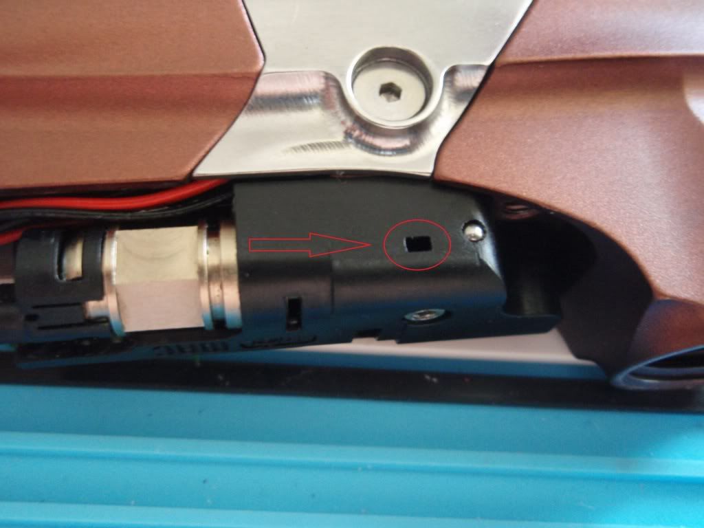

When I'm at work, most pictures get blocked, and I have to guess what exactly you guys are talking about half the time.
Having now seen the picture, I have to wonder if that is an intentional locator for the end of the spring, because if not, that is one hell of a fault to overlook.
Hopefully Nicky can confirm for you whether that is right or not.

Haha. That ball check is funny looking.

If there is air leaking through that hole, either the gasket is not in place properly or is damaged, or the solenoid housing is cracked.

That Back-check ball definitely is not right and need to be changed. If your back-check ball is in that state, i'd like to see the rest of your solenoid, so with that in mind can you drop me an email at: nick.t@planeteclipse.com and we'll get you sorted asap.

It was so far out of round that I really wondered if you had changed the design of the back check ball to capture the end of the spring.
It just looked too far beyond the norm to *not* be intentional!
