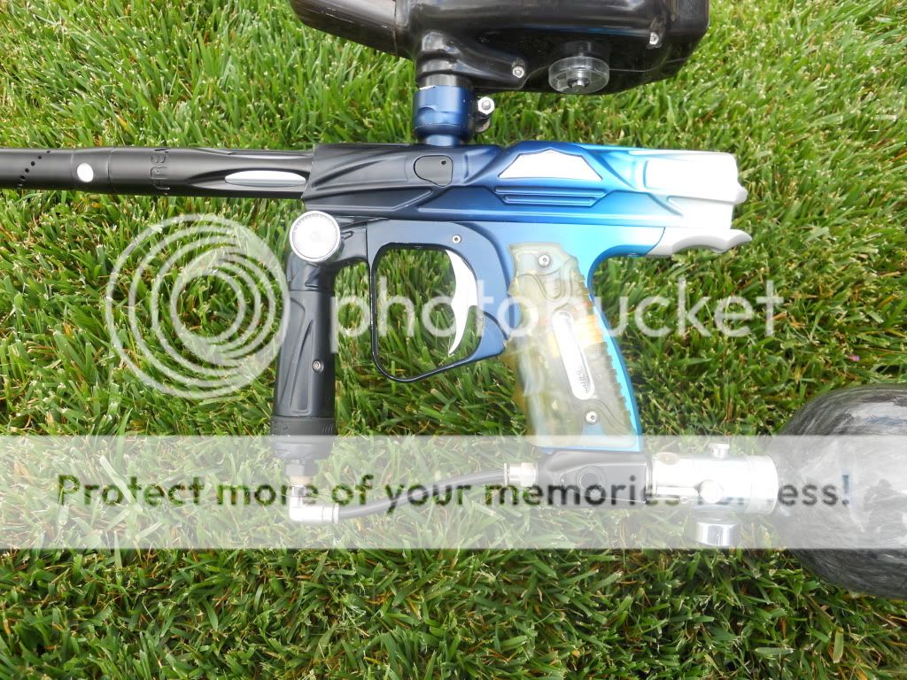

RitcheyMetals
Dedication to Domination
RitcheyMetals's Avatar
RitcheyMetals owns a Planet Eclipse Ego
RitcheyMetals supports Team VICIOUS
was this a team gun? and does anyuone know how many where made?

Old 05-05-2010, 11:52 AM #89
RitcheyMetals
wasnt asking what kind of nxt. i know its a dynasty. i asked if it was a team gun. i think it was from sd aftermath but i am not sure./

Old 05-05-2010, 11:55 AM #91
RitcheyMetals
i wasnt too clear myself sorry about that

Old 05-06-2010, 01:43 AM #96
Dawn_of_Man (Banned)
life is dawn till dusk
Join Date: Nov 2009
Dynasty NXT, it's one of the more common private label shockers.
it might be, i dont think they sold the dynasty nxt in that color. probably a custom request

Old 05-06-2010, 02:23 PM #101
RitcheyMetals
i think its a sd aftermath gun. but i am not sure

Old 05-06-2010, 02:34 PM #102
big_scott
Has a good personality.
big_scott's Avatar
Join Date: Nov 2001
Location: Columbus, OH
big_scott is a founding member
big_scott is BST Legit
big_scott supports DLX Technology
maybe and maybe not, I believe I saw one of those in the hands of either a dynasty or Aftermath player, however its most likely a limited production gun. They sold them in that color, as well as black-red-silver fade, and I think maybe a black-gold/yellow-silver fade that was much more rare.
