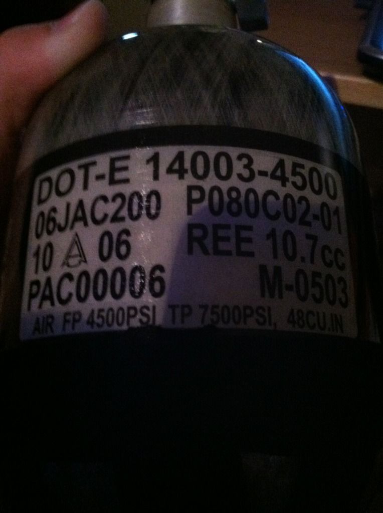

Does this need to be rehydroed?
Yes. Assuming it is a 5 year cycle cylinder, the rehydro for the cylinder was due 10/11, it was due last year.
