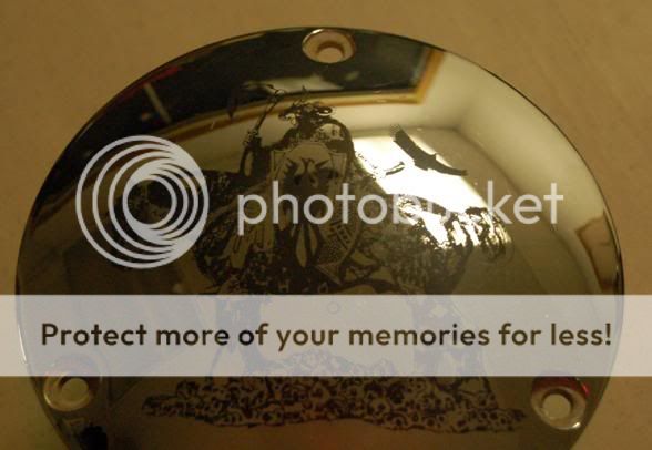

As far as I know Black Laser Engraving can only be done on chrome. Here is a derby cover I had done for my bike.
