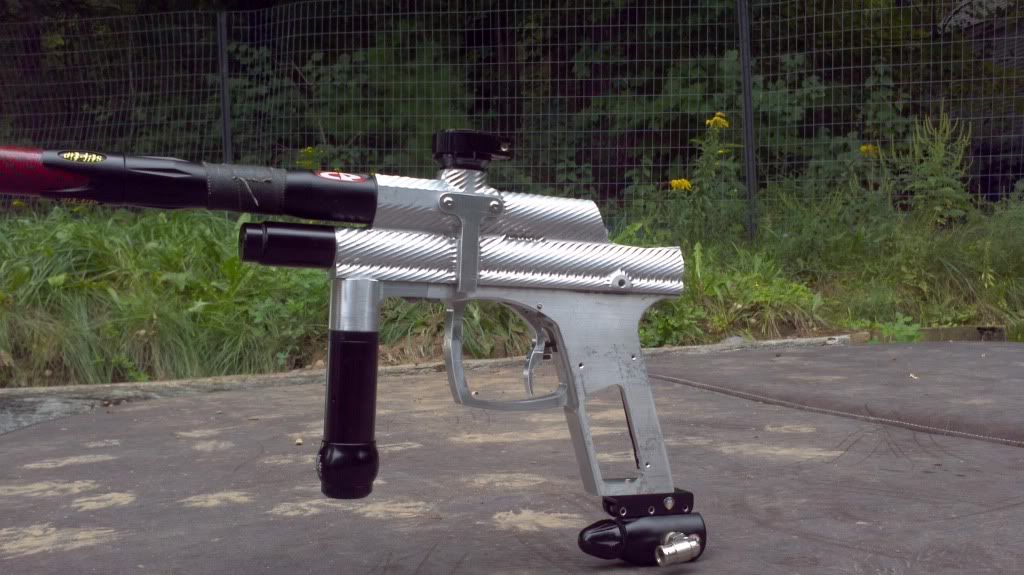

How is your hpr asa mounted and sealed?
PB Nation Mcarter Brown Custom Cockers Automags.org
Enfamous13 is offline   Reply With Quote
Old 09-20-2011, 09:31 PM #1034
lufkon
FX Anodizing
lufkon's Avatar
Location: westfield ma
I added 2 holes to the body that's how its mounted. And its sealed with an oring that fits In a groove on top of the asa
pbn- http://www.pbnation.com/showthread.php?t=1528310

Looks like it worked. Right now I have a frame design using the same thing you did except the frame and asa are one piece.
SME Certified Manufacturing Technologist
Machinist
OMFGSTFUBBQ is offline   Reply With Quote
Old 09-21-2011, 09:41 AM #1036
lufkon
FX Anodizing
lufkon's Avatar
Ya I thought of that but I like them seperated. For anno purposes and to make machining a little easier.

I just don't know were to start really. If anyone could give me a few tips or steps to follow to get it chrono'd that'd be great
Adjust lpr to around 80, dwell really depends on what board your using and use your hpr to get to velocity, if your pressure is getting high, higher dwell and star over
