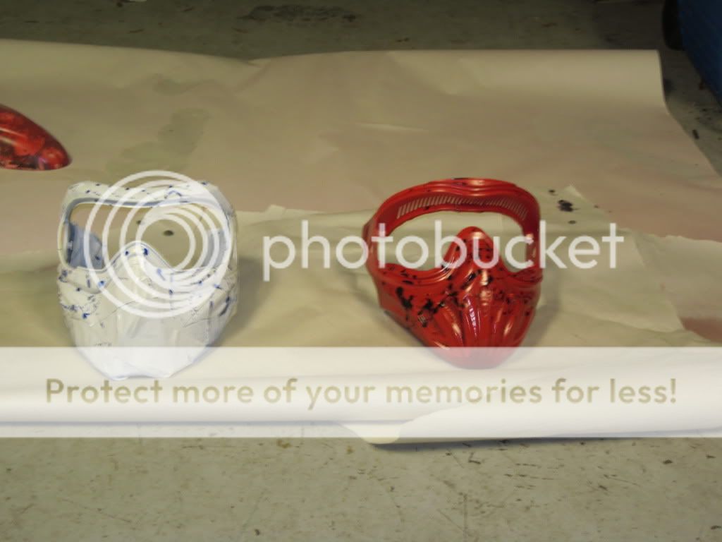

my first attempt the grillz are mine and the events are a friends

so does anyone know yet if painting the rubber bottoms of the mask works or not? i dont want to paint it then have it crack

no it does not work, the paint is only meant for plastics and wont hold up well on rubbery-flexy material

Auto body shops use a special mixture to paint the rubber bumpers, specifically to make the paint more flexible and not crack. You may want to check AutoZone or Advance Auto Parts to see if they have something you can use on the flexible part. Or ask a body shop.

They paint rubber (such as rubber rafts, wetsuits, etc.). So there are stuff available to paint the flexible material.
Here's what I found:
1. "Puffy Paint" from the fabric department at Walmart. It worked fine, it was a little thinner so apply multiple light coats.
2. Rubbery paint called "U-Name-It" works great on wetsuits.
3. Plasti Dip (http://www.plastidip.com/consumer/index.html). It's available in a few different colors as well as a spray can (nice for use with stencils).
