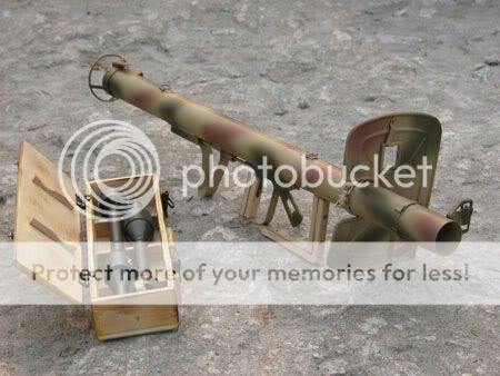

This is what i see happening lol

i dont have too many pics of your tank but ill check. have you sen our PAK 40 we built yet? Im hoping to retrofit a "Manufactured" launcher to the barrel so we can use it by ION

Sadly it has be since forever that any ref at the chrono station actually checked what my operating pressure actually was during the chrono check. Safety inspections seem to be getting lax. I have FELT a few hopped up commercially made launchers. Ref caught one with a dial a velocity reg shooting well over the speed limit. It got confiscated until the end of the game. I rarely see an on field chrono check of RPGs or Tank Cannons. A suggestion for the field owners and refs...
I'm using Co2 tanks for the air source. Most likely a 20oz that will be hidden in the rear and run to the ASA via remote line. The plumbing, aside from the barrel, is all brass gas line fittings.
The BURST pressure of 3in Schedule 40 pvc is in the 800 psi range. The Work pressure is usually considered in the high 200s. (260 I believe) Burst pressure can be found here:
http://www.engineeringtoolbox.com/pv...res-d_796.html
To be honest, I am unsure as to what my current operating pressure is. I don't have an air chamber, so there was no place for me to really add a reg. Ever disconnect a remote line on a live tank? Or have a macro line blow? That's basically what I have created, only with a trigger. This gun has very little power. I'm only getting about 100 feet off a shot.It's more like a giant blow gun as opposed to a paintball gun. It uses a long push of air as opposed to a pop of higher pressure air. I plan on getting in Chronoed as soon as the local field open up. I would be shocked if its shooting over 120fps.
Have a few pics of the state it is in now. Note the shameless use of the topless girlfriend to promote it ;-)
