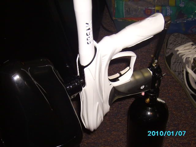

I decided to get this baby powder coated as a solution to it's fading problem.
It's gloss white and really beautiful in person, the pictures don't do it much justice though. I had to keep the white rubber pieces off because up against the white powder coating they look nasty.

havent seen this gun in person yet but i have done alot of work on it for him and its an awesome gun. almost no problems but the typical banjo leaks but all them have been fixed.

Very nice!!! that is sick! the only suggestion i would have is get a different grip, the stock one looks kinda goofy with all the white IMO
However, that is one of the sickest Epi's i have EVER seen!
Mind posting some details on the whole coating process? howto/price/where/etc

This only cost me $40, but the guy that did it said that $40 was pretty much the bare minimum for any powder coating job that they would do.
They sandblasted off the chrome plating on it, and used special plugs to fill in all the threads. They then polarize the powder and the gun to opposite polarities so the powder will stick to it. They apply the powder and bake it so that it melts the powder and solidifies over the gun.
As for where, you just have to google Powder Coating along with whatever state your in and try to find a list of places that do it in your area.
