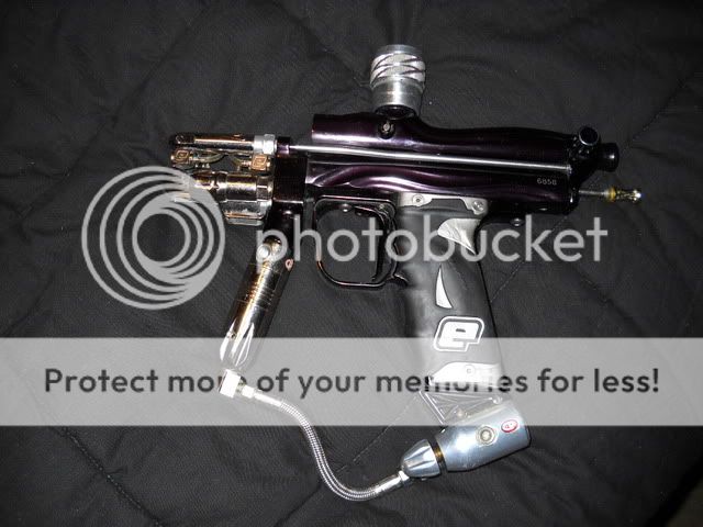

picked up a BlackMagic.. HELP!?
New to autocockers so i have no idea..
Picked up a purple to green fade Blackmagic today on craigslist
They say it hasnt been used for 2-3 years
When i air it up it leaks straight down the barrel.
What do i do?
How and what do i clean and lube before i air up the gun again?
Is there a walk through thread or video? Cant seem to find one.
How does the bolt pin come out? I've been pullin on it and its not moving. Its a black bolt pin, is there any special way to remove it?
Thanks.

Make sure you cock the gun before you air it up. (pull back the backblock untill you hear it click) That should stop any leak it has down the barrel after being aired up.. if not and its still leaking, let me know.
And check the stickies for maintenance and the such but you could always drop a lil bit of oil into the ASA after a weekend of play then point down the gun and dry fire it 20 times.. that will spread the oil through the reg and everything for some quick maintenance.
And for the bolt pin - if the bolt itself has a screw at the end.. try loosening that a little, then try to pull out the pin.

Took the gun apart. Bolt was in there right, cleaned out everything but the valve.
When i air it up, Air rushes right down the barrel and if i cock the bolt back then air it up the air still leaks down the barrel and then draws the bolt in.
any ideas?
Could it be the cup seal?

When i air it up the air does not cock the bolt back.
When i cock the bolt THEN air it up the bolt moves foward slowly while leaking.
Gun will not dry fire atm, Just leaking like hell
Anymore ideas?

i would try turning up your lpr as it does not have the pressure needed to hold back the bolt and i would take your valve out and inspect the cup seal that usually seems to be the issue whenever cocking it does not solve the problem
p.s. i would check the pressure on your reg it might be too high but that my .02

If the bolt is moving forward on its own, there has to be something pushing it. That means the ram, which means the ram is getting a little bit of pressure when it shouldn't. Sounds like the 3-way is leaking. Are you sure it's not leaking down the barrel? Put your finger over the hole on the end of the 3-way and see if it's leaking from there rather than the barrel.
You're going to have to slightly disassemble the marker to get the 3-way apart. You can try to relube it (I had to use some thicker paintball grease on mine rather than Gold Cup oil to keep it from leaking), but it's not a bad idea to replace the o-rings while it's apart.
If it really is leaking down the barrel, then yes, the cup seal is leaking. You do have to remove the valve to get that out, which means you need a valve tool. It's really not that big a deal unless you're mechanically inept, but you're probably going to have to do a little retiming of the marker when all's said and done.
Go here and read all of the appropriate tech articles before you take anything apart.

OK, before you air up the gun. look at the cocking rod...
now cock it. (pull it back)
now you may air up.
if you back block was in the "back position" it should now be in the "forward position" look at the operation of the gun here.
if you have a leak still coming down the barrel, from inside the gun.
then that means you can isolate the problem to your valve,
problems that can cause the valve to leak,
cupseal bad, or dirty
valve oring bad
valve installed incorrectly (you will need a valve tool)
pressure too low, can cause the valve not to seal on some.

cock the gun before you air it up. the leak down the barrel comes from the hammer resting against the valve and causing a slight leak. cocking it pulls the hammer back. its normal for cockers.
if you still hear a leak from the body of the gun, then you will probably want to replace the cupseal or valve o-rings. to do so you will want a valve tool, otherwise its very simple to do, it should be easy enough to find a guide.
the bolt will go to the forward position when its aired up. its a closed bolt gun remember. that means the bolt is in the forward position at rest.
if its leaking from the front of the gun around the pneumatics, its most likely the 3 way. either the o-rings are bad or its out of adjustment. loosen the 3 way shaft from the coupler and pull it out and inspect the o-rings. pay attention to how far it was threaded onto the coupler.
OR....it could just be that the gun has sat for a long time and all the o-rigns are just dry. put a generous amount of 3 in 1 or your favorite paintball oil (they are the same thing) in the asa and dryfire the **** out of it.
very nice orracle btw. looks like it has a CCM bolt and aftermarket ram...which could also be a ccm, im not sure what they look like, but thats my guess.
edit: oh, its actually a black to green, wgp's "black" just looks a little purple-ish lol.

I would not call this "normal' as none of the cockers that I work on or take care of do it. The ones that do it, have too low of an input PSI and too high of spring tension on the hammer. However, the marker will still work, just not at the best air eff.
While odds are if it still leaks you will need to replace the body o-rings or cup seal, you MIGHT, MAYBE will get away with lubing the hell out of it and cycling the marker. So first thing is first, you need to correct the timing so you can atleast start to dryfire/cycle the marker.
Odds are he is correct, but it could be MANY MANY other things..
. 3 in 1 and a good paintball lube ARE NOT the same thing. 3 in 1 will swell the o-rings....however, if yours are dryed out, this could be a good thing.
That is not an Orry. That is a 1st gen BM....
THIS is an ORRY...
