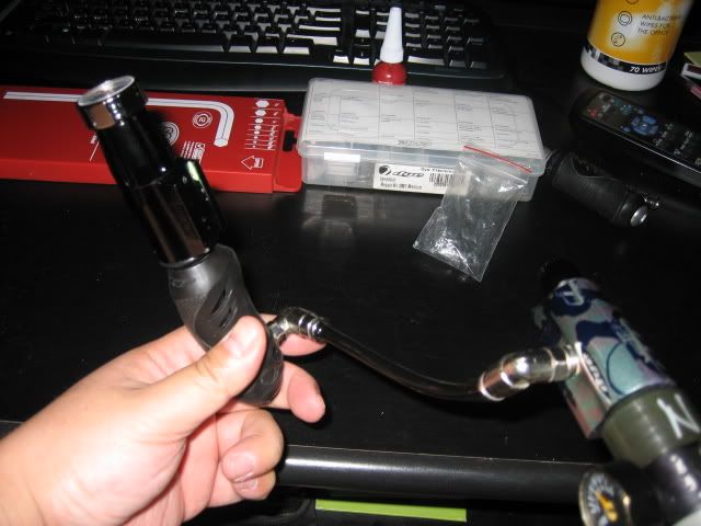

Thats my good old little regtester.
Using the quick on/off (i just used the porting oposit to where i attached the gauge) can help to check if the inlinereg spikes.
But a more detailed gauge would be nice.

Same System works to build a airsystem output pressure tester (just use a higher scaled gauge).
Many players don't even know what output pressure is set on their tank.
So when teching it helped me a few times yet
Plus you can use it as a regular on/off when working on a marker on the desk.

At least nowadays guns are easy to tech...you should have seen my old autococker...that thing looked like a freakin scene out of wierd science with all the gauges, hoses, clamps and bleeds set up to make that thing work!!!
But as Coyut mentioned, it's definitely helpful to understand how your components are operating to get the best results...such as demonstrated in this video:
http://www.youtube.com/watch?v=Bj8ScksTLMI
Just think if all the early GEO users had seen THAT before they called wondering why their guns weren't working!!!

am i imagining things Ben or does the ASA you are using to test the inline in these pics have dual side threads? That looks like an OOPS but all of mine only have porting on 1 side...and I seem to remember all teh way back to my EGO6 that it was single sided...am i wrong?

The one I'm using is from a Geo. It just has an Eclipse jewel on the other side.
The OOPS on my 07 Ego did have ports on both sides.
http://benjohnson.smugmug.com/Paintb..._XgFfv-L-1.jpg

Same method I've been useing for years to test output pressure. Works great ! ! !
