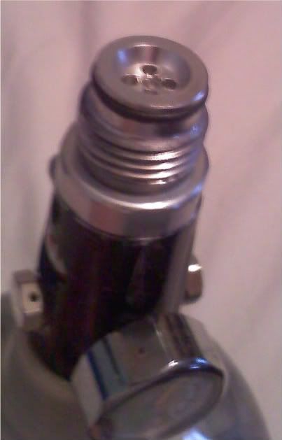

The pin on my CP tank reg has broken off, what should I do?
Here is the best picture I could get since I had to use my phone:
I can send you a couple parts that you would need to fix this problem or if you'd like you can send it in to me and I'll rebuild it (both options at no charge)

Ok I'll just ship it out to you, what address should I send it to?
I'll PM you
