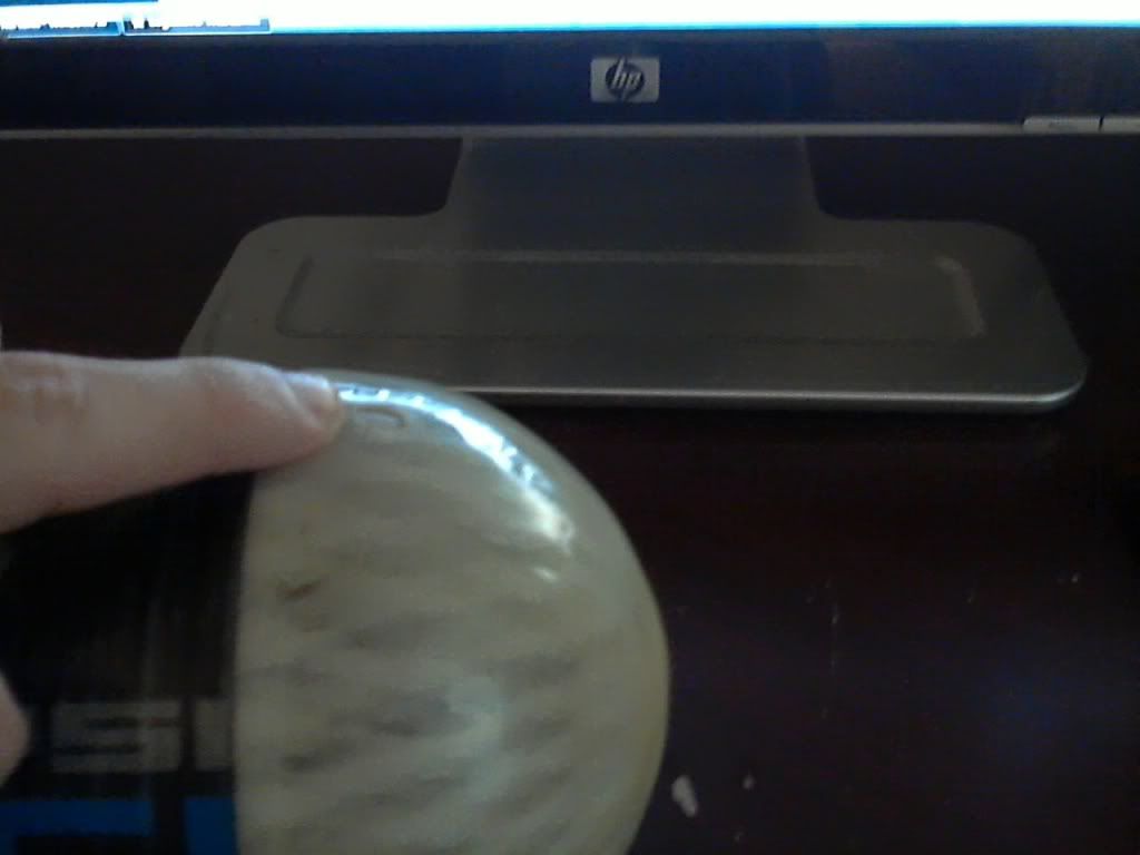

I just bought a used tank from the bst section here and it just arrived. The added mentioned it needs to be rehydroed and might need a new reg cuz this one is really old which it does and I am fnie with that. The one question I have is it came with a small chip in it and that WASN'T mentioned in the add. Will this tank still pass if i send it in to get rehydroed?
As long as it is just the clear outer shell and not into the carbon fiber wrap you will be fine. Fill it with clear nail polish.
