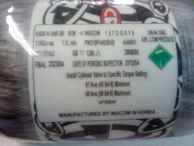

I just bought a guys gear bag and aquired a CP tank. No where on the tank does it list whether it is 3k or 4.5k, im thinking becuase it wasnt intended for USA use maybe. Here is a picture of it. Could you tell me what pressure tank it is?

It is a 4500 PSI tank, but you are correct, it is not intended for the USA, it is intended for use in Europe, Russia, and Asia area.
