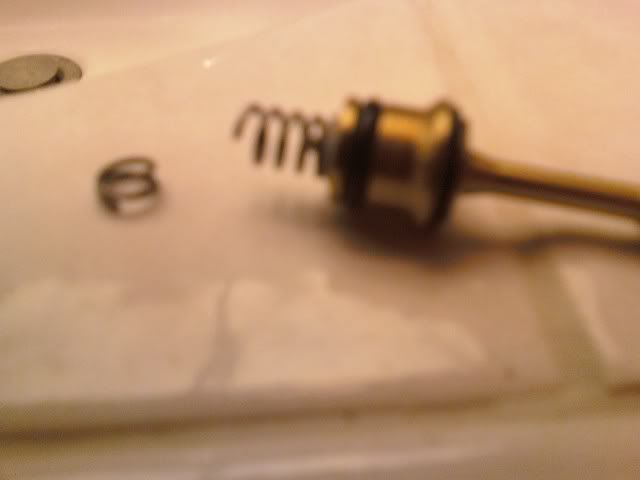

is the gen 4 suppost to be this finicky
i replaced all poppet orings, and ram orings, and used dow 55 on the whole gun. i set up the gun just like how it says, by putting both regs to flush. then slowly increasing the lpr to desired pressure, then adjust hpr for velocity.
but the thing is this works sometimes, and sometimes it doesnt. this past sunday, the gun wasnt working in the morning. i would set the pressures, but when i increased the lpr, it would just start to leak down the barrel, and the gauge would read zero.
then i set it down and use my dm for a bit, i come back, and reset the regs, and try and adjust the pressures again, and it works this time. the lpr leaks everywhere but 45 psi (which is the recommended pressure by lurker for the eigen ram which i have) if it would be a little high it would leak, and same with a little lower. The gun ran smoothly for pretty much the rest of the day, except one incident where the gun just gushed air down the barrel randomly, until i turned the air off, then back on, and it was fine running again.
so is there a problem that is causing my timmy to be so finicky?
PS my dwell was at 6 and lpr at 45 when it was running fine.

Gen4's are balance valve poppet guns, if you have your lpr set to low the hpr will over come the force of the spring and lpr psi and cause a leak.
Set your settings back to stock and go from there.
Also make sure you didnt get any lube on the middle poppet oring.

With the LPR higher/lower, is the leak from the same location, or is the lower pressure leak from the ram, while a higher pressure leak is down the barrel?
Such symptoms would be consistent with the spring I provide having weakened somewhat over time. I will provide a new one, or you can simply shim with washers to increase the spring tension, if this is the case.
If the ram/noid system is what leaks at low pressures, you may try replacing the front ram oring again after having soaked an 006 in dow55 overnight (or just let them swell a bit more). The noid can be weird at very low pressures, we had gen4s getting velocity down at the 30s LPR psi in testing but it just isn't healthy for the gun that low.
The poppet sticking issue suggests that maybe 1 point higher on dwell and a little lower on HPR would be optimal for your gun, IMO.

Ya it sounds like the spring is too soft to overcome the balancing effect. Try to shim it like lurker said, just to see if that solves your problem. If it does. then leave it like that until you can get a newer one from Lurker.
Like he said, running a low LPR pressure will require you to have a tighter, better fitting ram oring as well. That lower pressure won't swell the ram oring to the same degree as a stock 80psi would.

ok lurker so i tried what you said. so this is what happens
i turn the hpr to flush, and then increase the lpr from zero. the lpr gauge starts to move and gets to about maybe 20 psi while it is leaking from the ram, then if i increase anymore the lpr gauge goes to zero and starts to leak rapidly down the barrel.
PS same thing happens if i turn the hpr pressure down even more, like 2 turns out (less pressure) from flush.
im using dow 55 on both ram orings so it should be pretty tight fitting. i was originally using lurker lube, but then thought i should try dow 55 to see what a tighter fit would do.
and how would i go about shimming the spring. would i put something inside the rocket cap?

What's happening at high LPR pressures is that the poppet is actually being forced open by the LPR pressure at rest. This is pretty normal on an eigenrammed gen4, but usually it happens up around 70psi. This is a big reason why the stock gen4 spring is so heavy.
The spring is 7/32" outside diameter. A couple washers of that or similar size in the rocket cap will adjust your tension up and let the LPR go slightly higher without issue. This will also fight against any poppet stick. My guess is that the spring has a bunch of cycles on it and is "loosening up" with time.
The sealing issue at low LPR pressures is due to the front ram o-ring - shaving the bottom of the bolt pin (so the bolt doesn't press down on the ram AT ALL) will help this issue. Shouldn't be needed, though.

i think i have found the culprit.....
how easily problems can be solved when i just take apart the damn poppet
that little piece was just sitting around in the rocket cap

yea, and 5 coils is not enough to do the job properly - I wonder if it got nicked in the grinder we use to flatten the ends out...
