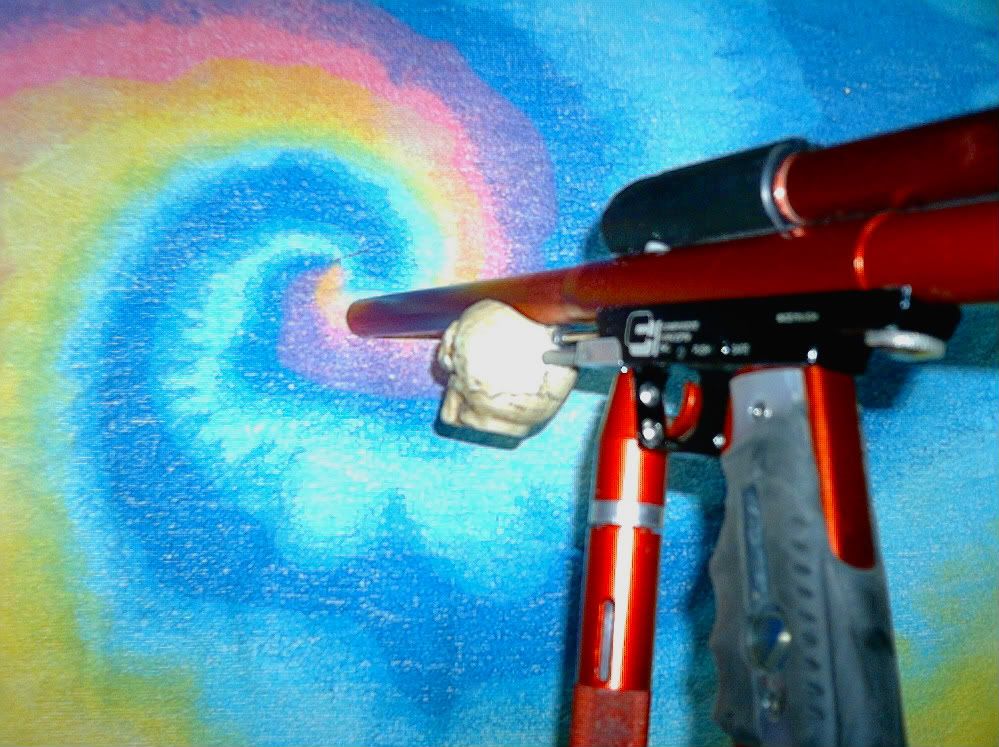

Let me start off by saying that I do not personally know z.bart, so this is my honest opinion of the product. I posted in his thread saying that I wanted to test his pump kit, and he decided to would make a good tester.
This is his undercocking kit for phantoms that is currently in the testing phase, so it may not be exactly what the finished product will be like.
The box i recieved came with:
Pump
Mounting block
Spring
and a screw.
The first thing i noticed was the spring was awful for this pump kit. The way he designed it was for the spring to go inside the handle, but the width of the spring was too big which caused internal rubbing making the kit not smooth. I was fortunate and had an extra spring that fit over the guide rod which helped out tremendously.
Luckily for z.bart, that is the only real flaw i could find with this kit (i wouldnt even really call it a flaw because its a $1 fix...).
Everything else about this kit i loved.
The shape and construction of the kit is great. I took off the stock pump kit and compared them side to side. Both of their heights are about the same, but z.bart's kit is slightly wider which makes it feel great (especially for people with bigger hands). The little indents on the side remind my of the PMP pump kits for autocockers. This little indent provides great grip and really helps the handle conform to your hand.
The material that it is made out of is some composite. It is nice and light, but also feels very durable. The only downside i see with the material right now is that it leaves machine marks, but maybe a light sanding with fine grit paper will do the trick. This is probably going to be something that z.bart takes care of in the production models.
The guide rod is pretty standard. It bolts onto the body right where the front screw would go. It was somewhat tricky to get it on when trying to assemble the gun, but i found that using electrical tape to hold it in place make installation a breeze.
The most important part, and probably most impressive, is the stroke. After installing this pump kit my stroke went from being a typical phantom stroke to an almost sniper stroke (lets call it a heavily sprung sniper stroke). It is extremely smooth, yet has a nice snappy action to it. The only problem with the stroke is that it can twist since there is no guide rod. But as long as you can pump a sniper without a guide rod, you can pump this easily. This is actually easier than pumping a sniper without a secondary guide rod. Usually if you twist a handle as hard as you can and then try to pump it is very difficult, but with this you cant tell a difference. So in that sense it has a leg up on a snipers pump stroke.
That is pretty much my review for this kit. Aside from the little spring issue there is little that i would change. The only thing that i might think of adding would be a secondary guide rod, but in reality it doesnt even need one. I look forward to seeing the finished product!
As a little disclaimer, i have not had a chance to try many other undercocking kit for the phantom. I have tried the wevo kit, which seems to be one of the more common ones, and this one feels much better than wevo's kit.
Now for the pictures:
SUMMARY
Pros:
Light
Smooth
Snappy
Feels great in hand
Cons:
Needs a different spring
I will post up what i think when i have had more time to use this and if anything changes.

i think it would be a little more comfy if it was round at the front

Thanks for an honest review, thats the only way i can make things better.
I will work on the spring issue, i wanted it hid in the handle to keep it clean looking. As for the front, there will be much more of a radius for comfort and it will be much cleaner(no tooling marks).

Its kind of weird though, because when i usually hold my pump i wrap my index and middle finger around the front of the pump, but with this one i dont do that. The grooves naturally attract your fingers. Its hard to explain. But you are right, when i wrap my fingers around the front it isnt as comfortable as the other way.

i think haveing a variaty of handles would be nice, that way you can choose what stle fits you the best

Yes, i am aiming at offering a variety of handles and i am only doing
5-10 at a time so if someone wants something other than the standard model i can throw it in the mix, i just hope that if the demand is enough i can keep up.
Also, i want people to be able to customize it to their taste, there are allot of things i can and cannot do just depends on what the person wants.

Yes, the mounting block is aluminum on the prototypes but i am switching to a High Density plastic for production, i don't want peoples frames to get marred in any way.

After playing around with it a bit more i think that if it were an inch longer and rounded at the end it would be perfect. The shortness doesnt bother me too much, but i feel if it were longer it would be much better.
