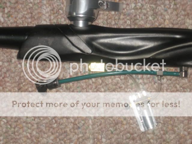

Mech'd Ion How to
Since I was asked to post a "how to", here it is.
Parts needed
Clippard SMAV3 three way valve, clippard QEV, 2 banjo fittings and a T33-2 T fitting.
Mount the smav 3 on an angle piece of aluminum.
Place the T fitting close to the rear banjo fitting but far enough away that the frame will not get in the way of the hose going to the SMAV3. The hose from the T fitting goes to the In on the back of the SMAV3, hook up the hose from the QEV to the N.O. barb on the SMAV3.
Locate the SMAV3 Acuater pin to the back of the trigger, drill and tap the frame for a set screw to hold the angle into place and hook up your connections. Adjust the trigger to have contact with the acuator pin (but not depressing it).
www.airsoldier.com
www.clippard.com
you will be able to find the parts you need at clippard.com, Airsoldier will be cheaper but they are sometimes out of stock and do not carry the T33-2.

Originally Posted by PBFreak875 View Post
Sweet, man. 2 questions: How long/heavy is the trigger pull, and what's the approximate cost?
trigger pull is about the same as tippmann and cost varies you can get all the parts except the T fitting from www.airsoldier.com and save a lot of money in shipping or you can get them all from www.clippard.com and pay about 18 bucks in shipping. I bought a lot of things at once from clippard which made the shipping charge worth paying.

No, you just need to have a drill and the proper drill bit for the tap size.
I use it for reball and it shoots like a laser beam.

Thanks JT
The trigger pull isn't that bad, But it isn't like the micro switch either. I use it for Reball and even when my team is using their electros against me I don't feel out gunned.
