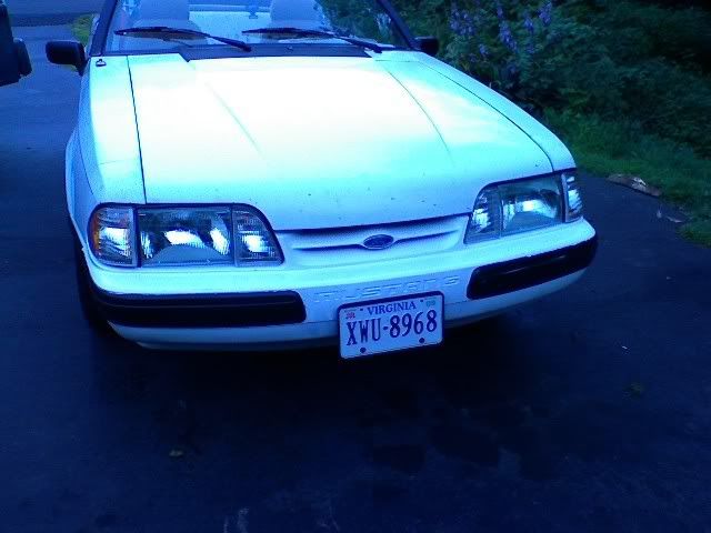

this is how it sat when i bought it :

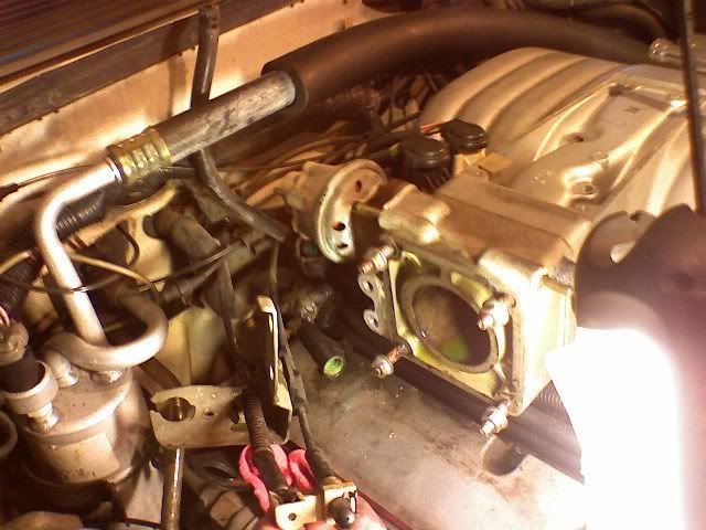

Found out the car had a massive oil leak, thought it was the rear main seal. Turned out to be a clogged screen under the pcv valve, blew the valve cover gaskets. While the valve covers were off, i sanded and polished them.

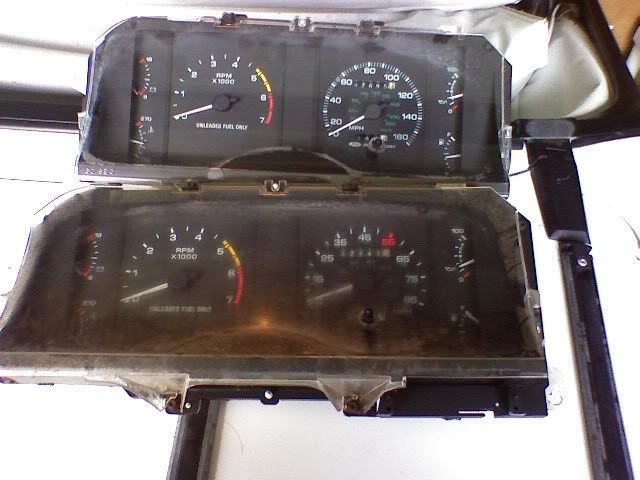

Next, i got a new (used) speedometer because mine was so fogged up. new one is 160 mph.

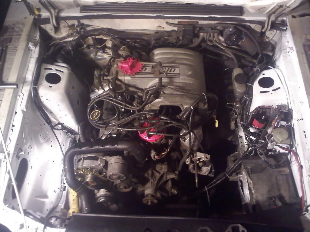

I then started gutting the interior of the car.
I got some packages in. 255 fuel pump, bbk shorty headers, bbk catted mid pipe, ford "b" springs tokiko blues, bushings, clutch cable, quadrant, steeda tri ax and new rear control arms.and probably alot more im forgetting. I bought the white seats off of craigslist for $150. Front and rear. The nasty white seats where what was original. It had tan 94 seats for the drive home i got out of a pick n pull.
at this point. it is on jackstands. the exhaust is out. the rear is out. the gas tank is out. and the radiator is out. i have pics, but they are not very good. i will get better ones today.

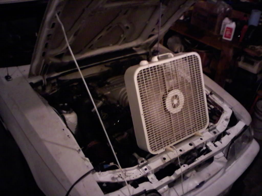

over the past day or so, ive finished taking the other shock and strut out. i got the rear shocks out, started with the power steering and starting preping the torque boxes for welding and i started cleaning the engine bay. ill have pics later tonight.
ok so tonight, i got the headers off, got the rack and power steering like 9/10 off and im trying to figure out how to remove the ac. it has r134a if someone could give me a hand. i also did a little twoards cleaning the engine bay. im gonna do the best i can with the engine still in.

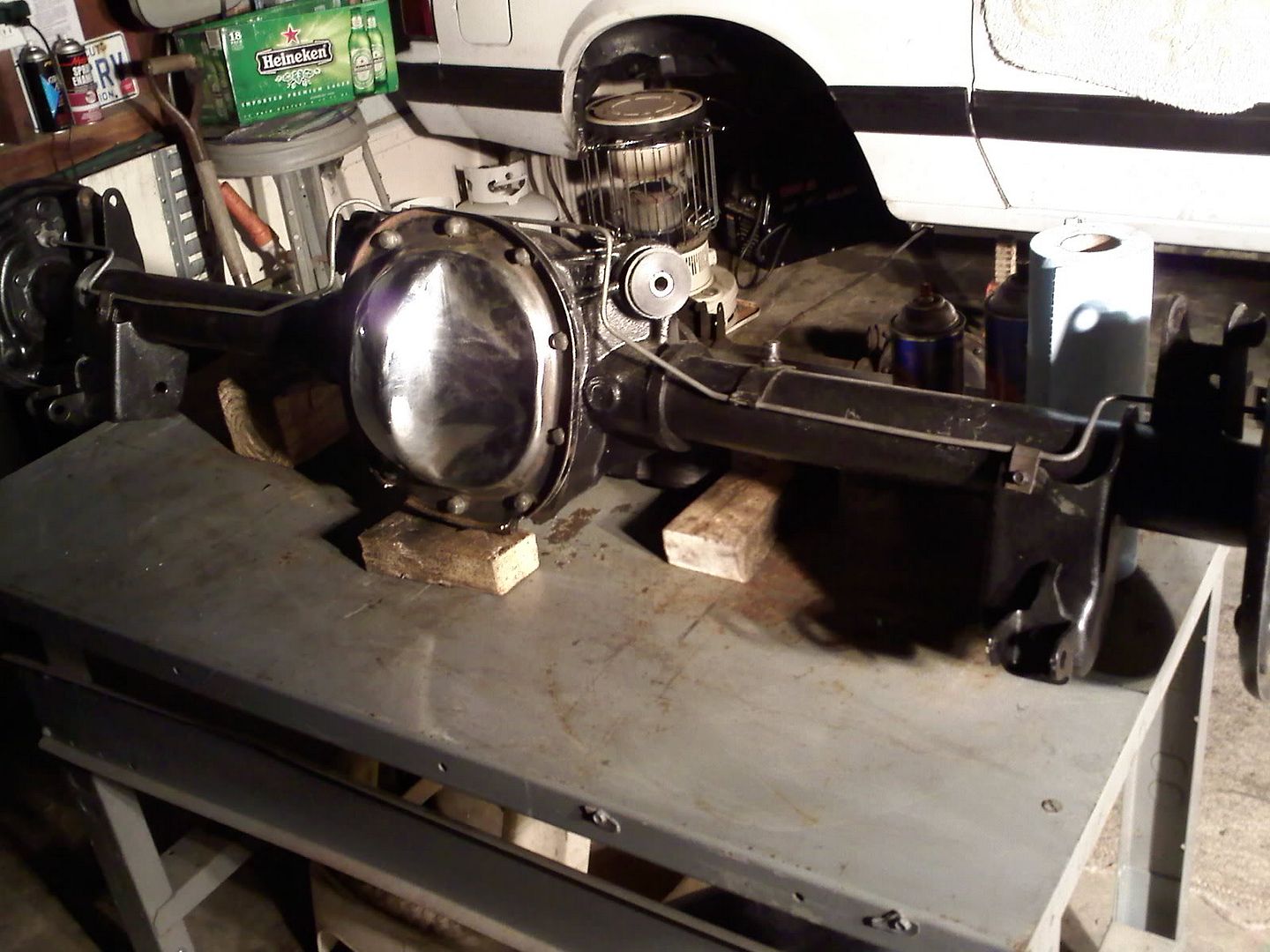

ok so ive done alot since last update
we got the rear end 90% in. (messed up one bolt i need to change)
welded the control arm mounts (idk what they are called, i just welded the seems (im not a great welder))
i started with the engine bay painting.
and we got the gas tank back in with a new pump and sending unit.
and since im that anal, i painted the drive shaft too.
