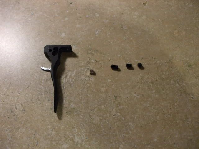

When I recieved the trigger it was shipped in a nice padded envelope with some of the foam popcorn in it to protect it. When I took it out I found that it came with 2 magnets, the trigger of course, and 3 screws of various sizes. The finish on this trigger is amazing! Perfectly shaped and light! I believe the screws are of different lengths so you can adjust how far away the magnet on the trigger is from the magnet glued to your frame. This changes the amount of force that is needed to depress the trigger though its travel. On the back of the trigger fang is a nice shiney piece of metal (or metallic tape) so that it will trip the optical eye for all of you with the optical trigger. It is a very slick piece of engineering I must say, and should work even better than those of you who have the stock trigger. The hole for the pin is the PERFECT size for the pin to glide on, and I say glide because there is so little friction you wonder why people need bearings. The pin fits perfectly in the hole, allowing for minimal side-to-side play (TBO discussed just how much in his F8 trigger thread, and I have no reason to believe this isnt the case).

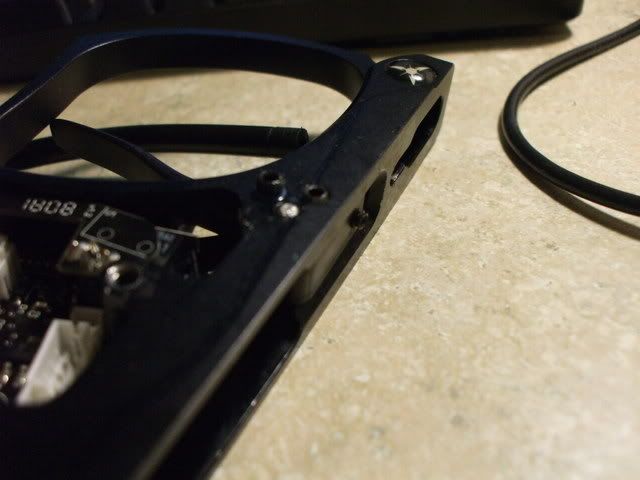

Now I have the Virtue board in my F7, and the microswitch poses some issues. First, when you put in the bottom throw screw to set the forward travel, if you put in the screw more than 1/2 way the trigger is depressing on the switch already and wont allow it to reset. The trigger fang is the stock length so it will work with the optical sensor as the part that actually needs to see the fang to trip the solenoid is set back further than the actuation arm on the microswitch. Two things can be done to remedy the situation, either cut down the fang, or leave the set screw half way out. I chose the latter as in the future if I ever get rid of the gun, I want the ability to sell the trigger to someone else who may not have the microswitch. If you leave the set screw half way out, it is flush with the grips anyways, and you cant tell the difference. See the photos below to see what I am talking about.
With this trigger and board combo installed, I have been able to set my entire trigger travel to just about an 1/8th of an inch (if you look in the below picture, the trigger travels from the front of the 'S' in the serial number to the back of the 'S'). The magnets provide the perfect resistance for the pull, and I have it set using the medium length screw, about half protruding out under the trigger towards the frame. I occasionaly will hit the trigger on a 45 degree angle rather than hit the trigger square to the face, and with the trigger being so slick it still travels and activates the board. There is no firm way to determine how many BPS I have gone up while using this combo over the stock board and trigger combo, but I can easily tell that the trigger pull is smoother, faster, and all-around better with the trigger over just using the stock trigger and the Virtue board. When these are available from TBO, do yourself a favor and get one!
