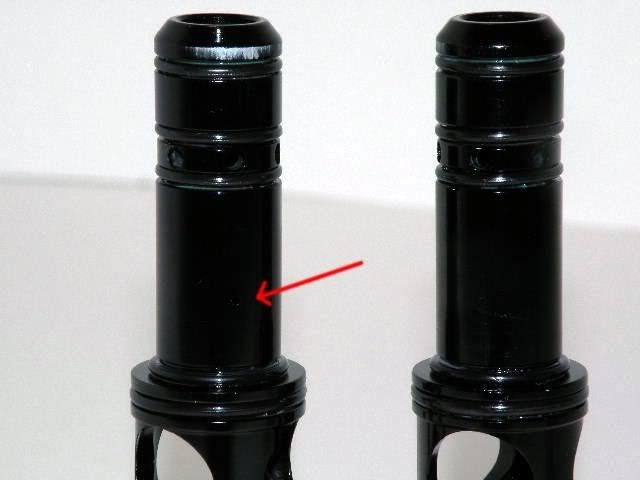

Bolt Guide - Part#27 - Kee added a bleed off hole to vent air down the barrel in the case that a ball or finger stopped the bolt during it's cycle. (red arrow)
Bolt Guide - they also took off one of the retainer screw grooves.

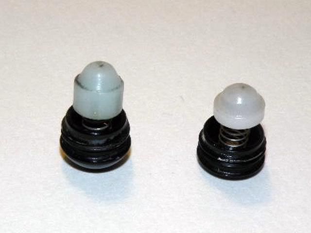

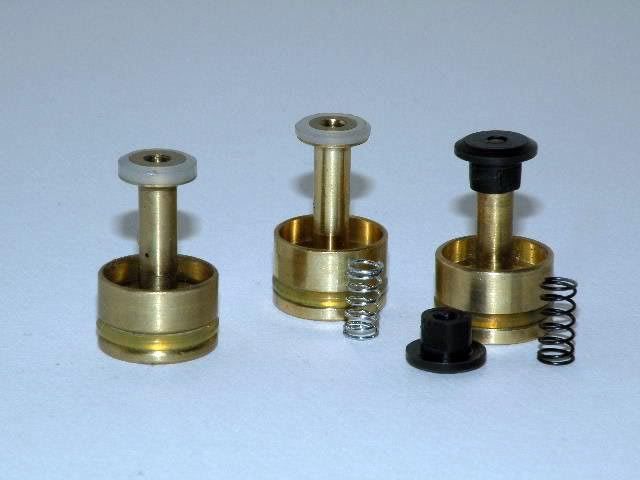

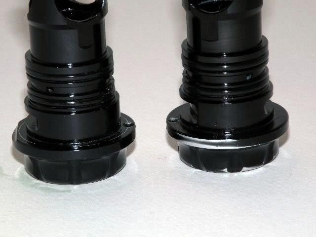

Poppet - Part#33 - Left to right; V1, V3, V4. This does not include the defective poppets, they were machined wrong and don't count as a version. The fix for the defects were essentially a Version 1.5. Version 3 added a spring, to self-reset the poppet (part# 79). Version 4 added a two-piece design to allow for the replacement of the face seal (part# 80) This part is pictured above in black delrin, however the production version is white nylon.

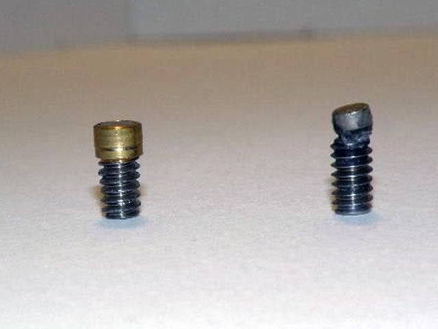

Trigger activation magnet screw - Part#70 - KEE added a threaded magnet to stop the darned thing from falling off every time you opened the grip frame.

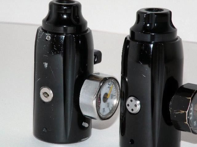

The Regulator Part#53 - Version 2 added a flush mount bleed valve, as well as changed the position of the front cap retainer set screw to the top to keep newbs from causing serious damage to their minis. It's also worth while to note that early Invert Minis came with a 600psi micro gauge, while later minis came with a 300psi micro gauge (part# 62).

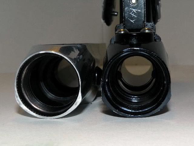

Main Body Part#1 - You probably can't see from this photo, but the inside diameter of the landing BEHIND the threads was enlarged on later bodies to allow for the use of all autococker threaded barrels. (the old bodies don't fit some large diameter barrels like the old freaks and some J&J barrels)

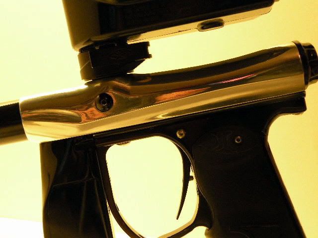

Polished - a close up of my fully polished mini body

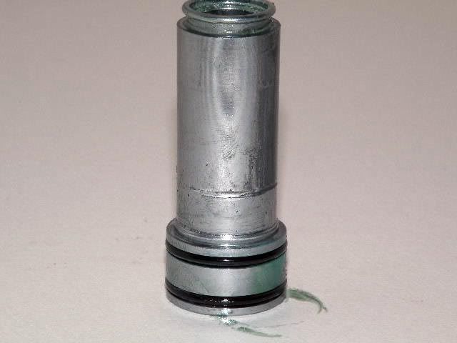

BOLT - Oh and here is my stock bolt, used on mini number 001700 since I got her two years ago, every weekend, case after case, tournament after tournament. Yea she's ugly but.... hey... stock performs the best!

what are the advantages of the gen 3 poppet over the gen 2 poppet?

you can replace the face seal, which is available in packs for less than the price of replacing the entire poppet (because the face seal is a seal just like an o-ring and wears out over time)

Version 2 introduced the spring into the poppit? Because i have a face that resembles the second version but no spring!

FYI:
the poppet in the picture with the black head is not a production v4 poppet. the production head is off-white nylon, not black.
