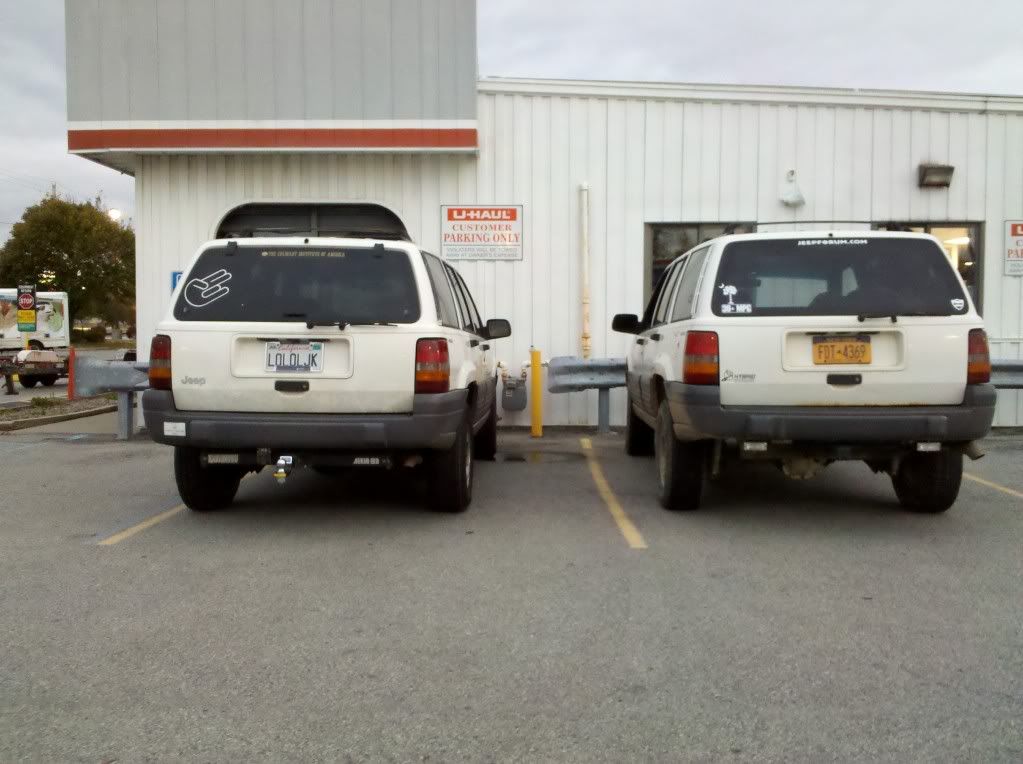

Parked next to a sibling a while ago. Wanted to see if the difference between us was noticeable. It is, slightly, but definitely needs moar lift!
4.5" coming Spring '12. Cant wait!

Originally Posted by SCPIMPULSE16 View Post
LOLOLJK
