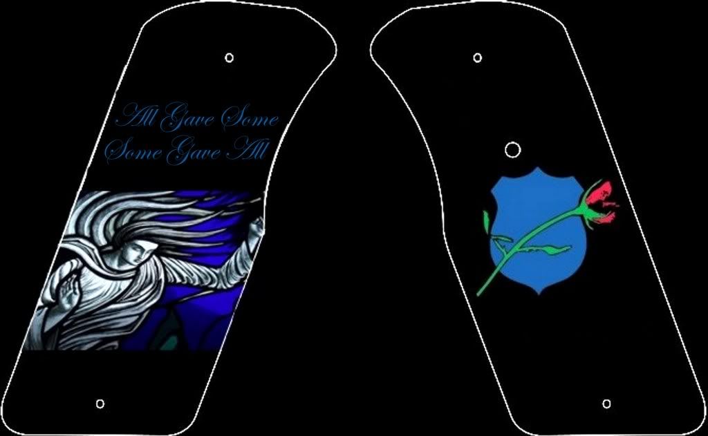

The size of the lexan that I just bought was I think 18x24 from Lowes. I also just found some clear sticker paper that you can print on (you have to mirror the image though so that why when you put them onto the back of the lexan it reads correctly). I am going to either print out the design with the badge and rose and of st. michael, or make some using the image of the stickers I got from Virtue and put them on some new grips I am going to make this weekend with my wife out of town.
This is what they will look like:

Here are the updated pictures. I used Avery #18665 sticker paper from Office Depot ($10 for 10 8.5"x11" sheets). If you do this, the image has to be fipped horizontally so that when you put the stickers on the backside of the grips they look correct through the front. I also put another layer of the sticker paper over the printed copy so that there is little-no chance of the image rubbing off. MAKE SURE IT IS DRY FIRST! Yes, the grips are a little hazy---I need to polish them.
