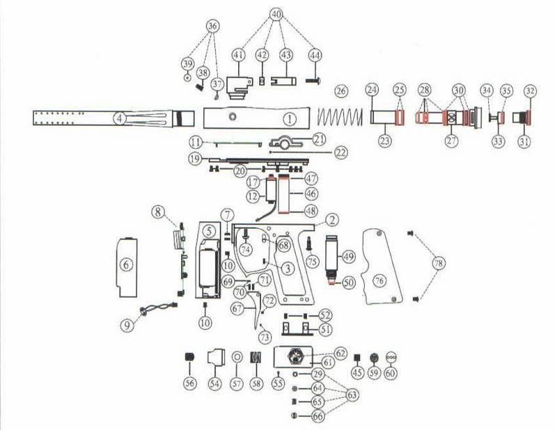

By setting the pressure to high you might have broken a oring/ seal. Take your Mini apart (if you know how) and check it out.

Originally Posted by stubborn View Post
Which O-ring would I have broken?
Could have broken the one right on the ASA (#50), or broken the entire seal in the middle of the body (#21).
